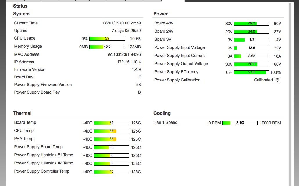

Can you please post up the a screen grab of the Device/Status TAB of the units that causing you issues.

ch0g
Posts: 4
Joined: Fri May 19, 2017 10:54 pm
Re: WS-12-250-DC switch config loss upon de-powering port/sa
Mon Apr 02, 2018 9:25 am
Attached :thumbsup:

So the input voltage is around 13-14 volts.
Please describe how the switch is powered.
How much is the total watts being used.
Unselect all ports and show the main Status TAB which will show what each port is delivering and at the top the total watts being used including the switch plus POE.

The switch is directly powered by a 130ah 12v AGM battery. Supply charge mode from mains charger.
Complete current draw is 44.2W
