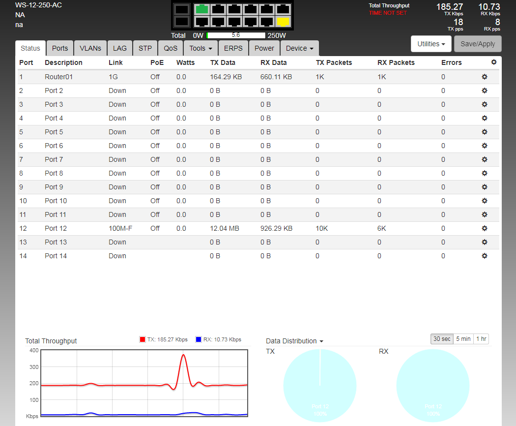

Hello,

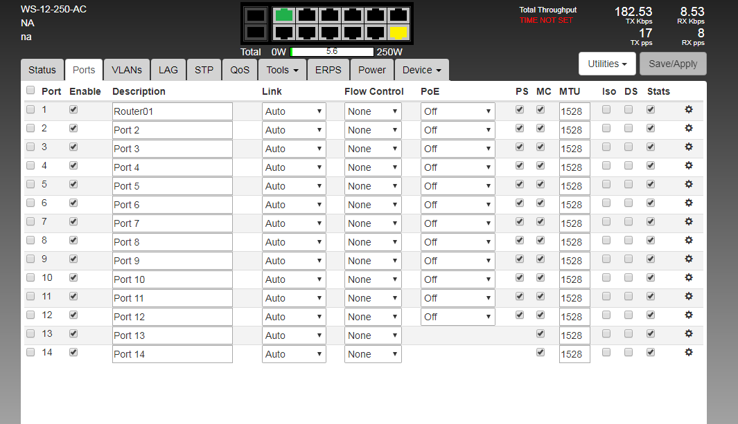

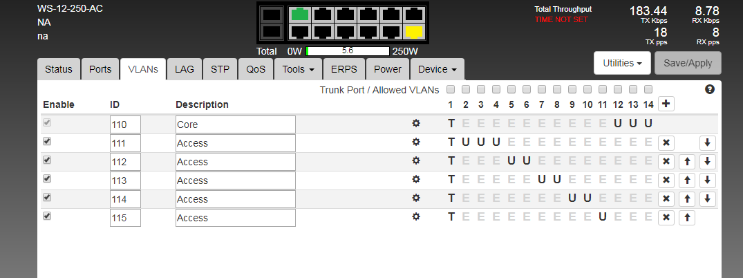

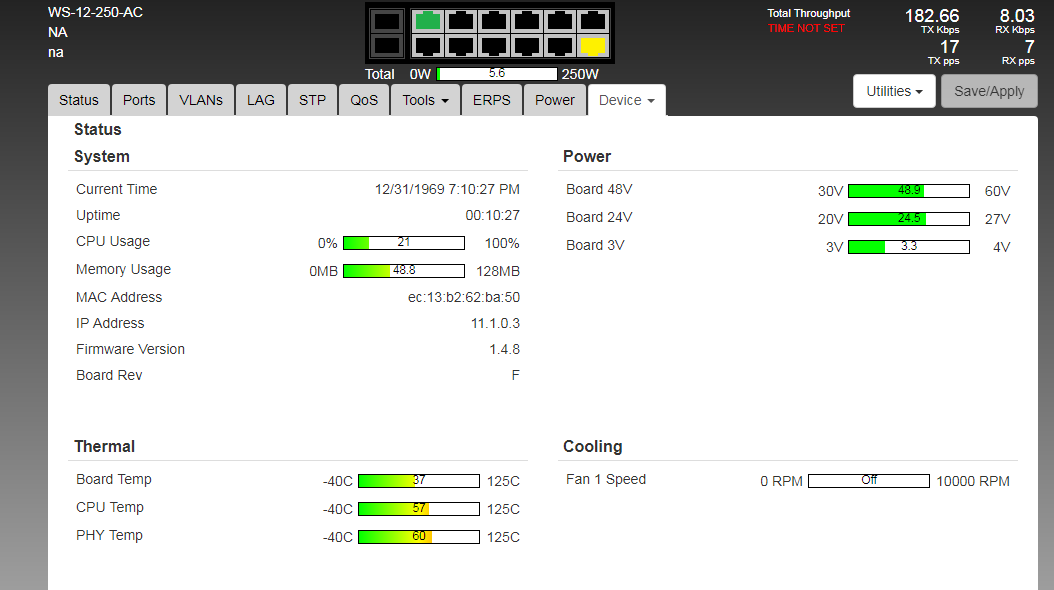

I'm having an issue with a brand new Netonix WS-12-250-AC. I unboxed the unit, upgraded the firmware, and started to configure ports. I noticed that nothing would get a link light when connecting to port 2 so I disabled the port in the GUI then renabled it but it won't link up. Below are screen shots from the unit. **My router is attached to port 1 and my PC is attached to port 12** Any and all help is greatly appreciated!
