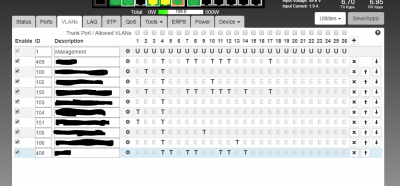

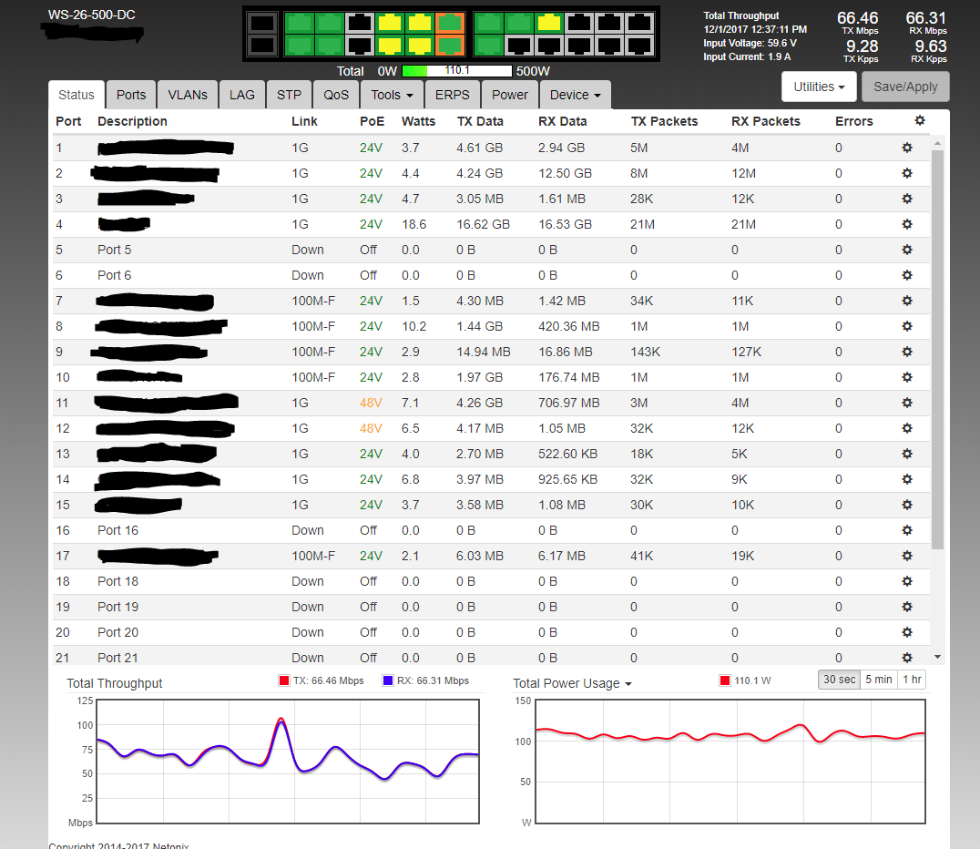

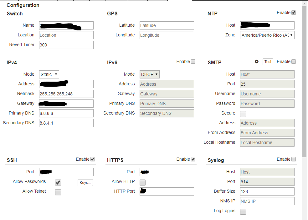

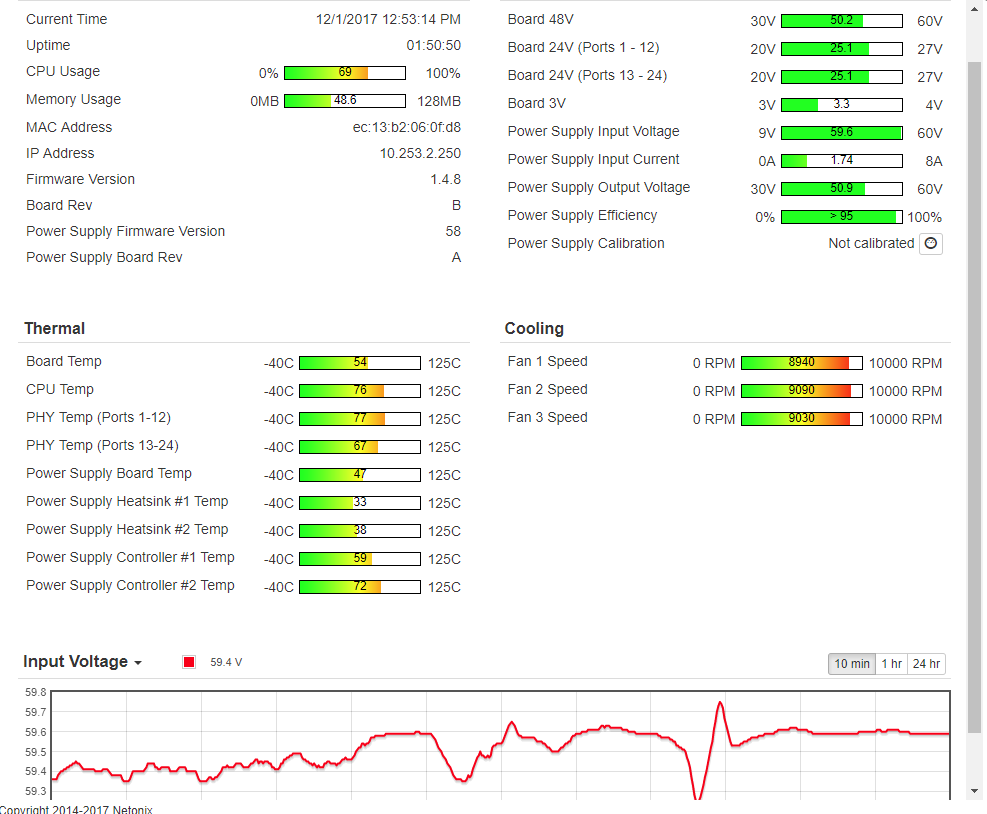

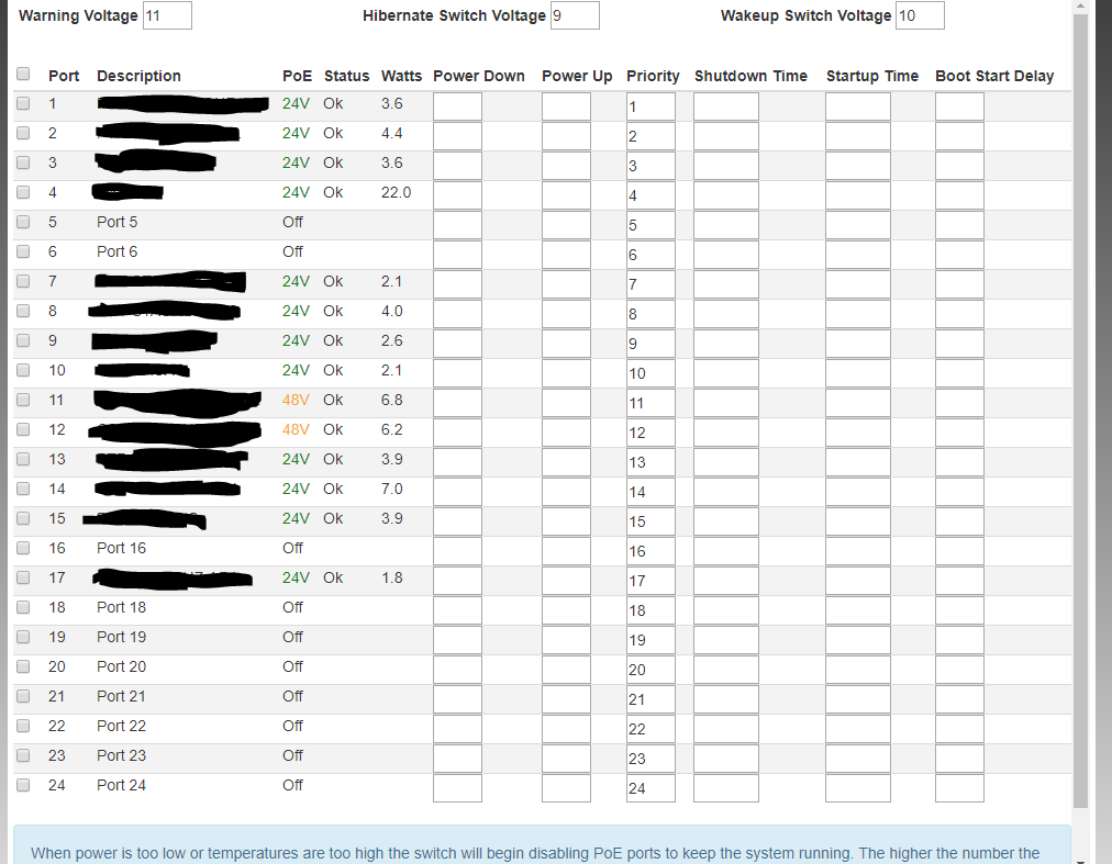

Please post up screen grabs of the following TABs:
Status
Ports
VLANs
Power
Device/Status
Device/Config
Any other TABs with changes

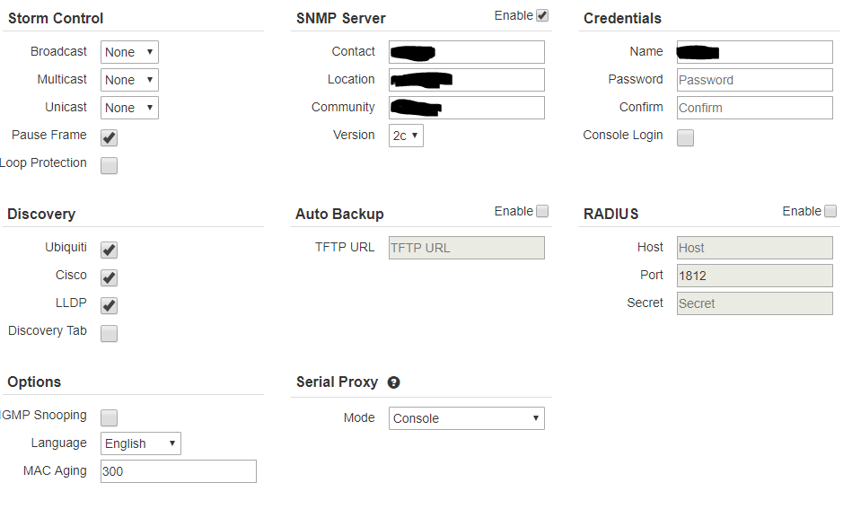

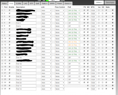

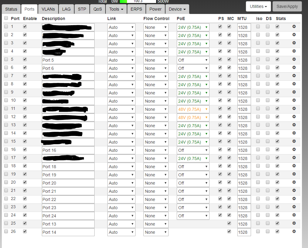

https://i.imgur.com/muSNvKu.png
Right now, someone made a change in config to an AP and it went down. Apparently, if anything causes the port to drop and come back up, it'll lose communication.

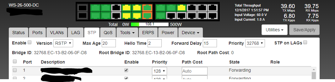

1) Please upload screen grabs as defined in my footer which makes it a lot easier to view screen grabs. Upload each TAB as a separate file. Do not make a new post go back and edit your post with the link to the screen grabs. Also do not block out port descriptions if they indicate the type of radio or device on that port. If you have some information you do not want then edit picture but let us know what device is on each port in the port description.
2) You should disable STP/RSTP on any switch port facing an AP and the radio itself, reference these posts:
viewtopic.php?f=6&t=3225&p=21369&hilit=+disable+AP#p21369
viewtopic.php?f=6&t=3165&p=21093&hilit=+disable+AP#p21093
viewtopic.php?f=17&t=3086&p=20855&hilit=+disable+AP#p20855

I tried disabling RSTP, but it didn't make a different. RSTP is enabled on by default, no? It was configured that way on the other switch and I never had this problem. I can disable it, that's not a problem. The AP is still exhibiting the same behavior.
Re: WS-26-500-DC Traffic Problem
I would disable STP on all the ports facing the radios and make sure it is disabled in the radios
