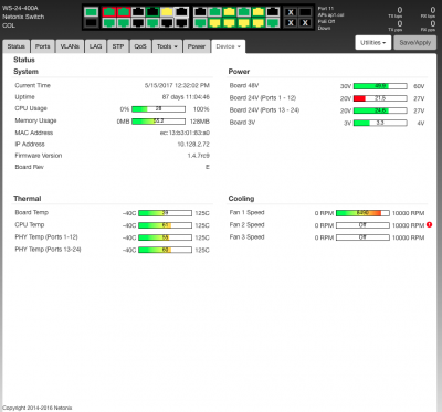

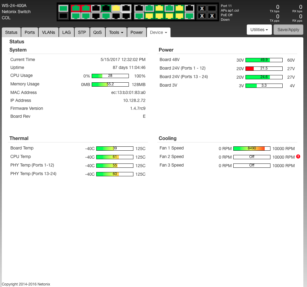

Can you post up your Status Tab
I am thinking you may have some damage on ports 11 and 12 that took out current sensors and or transformers.

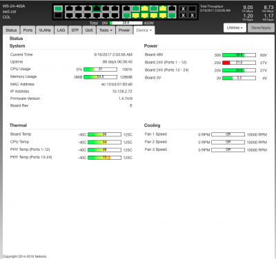

Mon May 15, 2017 3:48 pm
I will try the upgrade tonight during maintenance time. In the meantime, I'll build the WS-12-250-DC to take over in case of total failure.
We've had a lot of weather over the past month, but nothing since the 11 th. Doesn't mean damage didn't happen before then.
Any chance of a cross ship if we still think it needs to be RMA'd after the software upgrade and hard power cycles? We can survive without the 48 port for a few days, but we'll have PoEs all over the place. Ugly. But it's what we had before the Netonix.

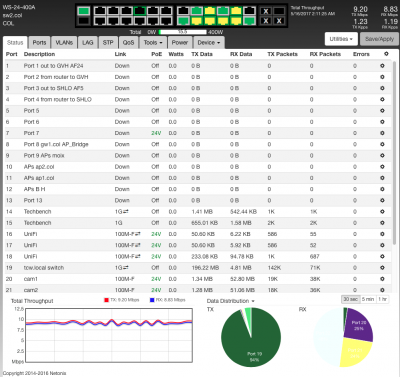

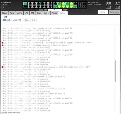

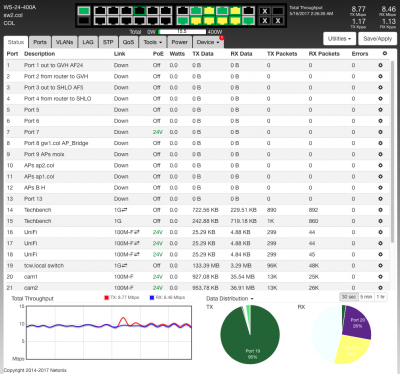

Tue May 16, 2017 3:41 am

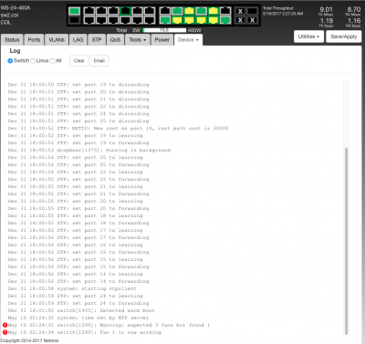

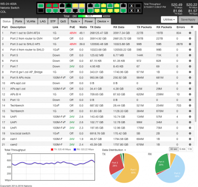

After moving important traffic off the WS-24:
After tools -> reboot:

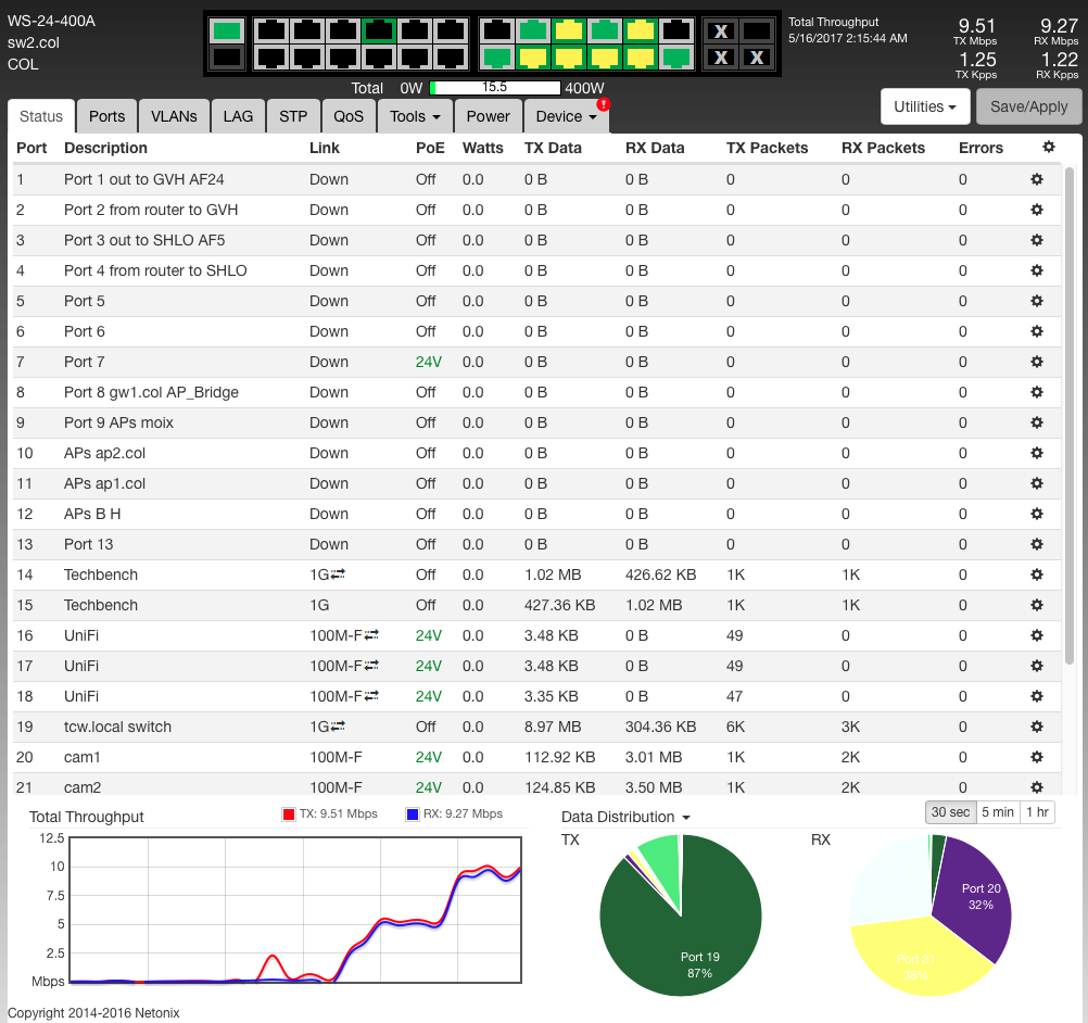

After pulling power cord for more than 60 seconds:

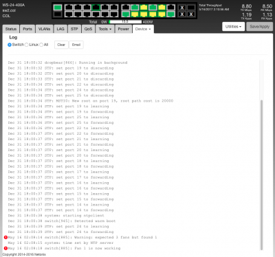

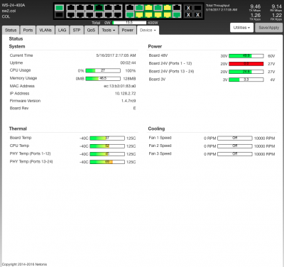

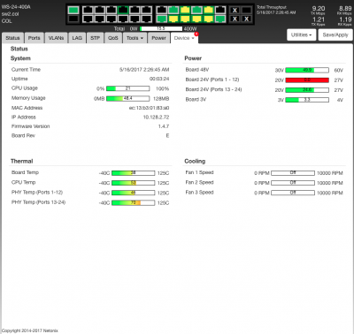

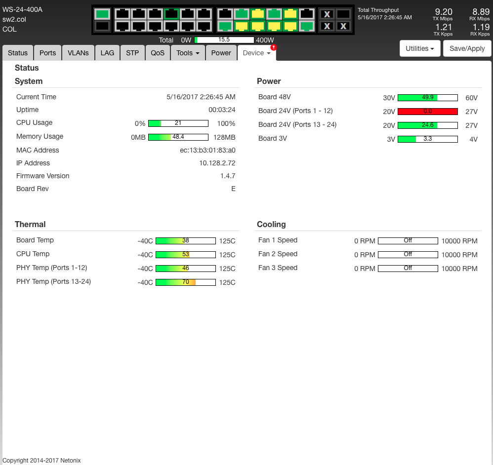

After firmware update to 1.4.7:

Re: WS-24-400A 24v rail low, no power to two devices of sev
Tue May 16, 2017 10:13 am
yea, you will need to RMA this unit.
It either has a failure or was damaged.
In case it is damage it is always good to review your grounding system.
