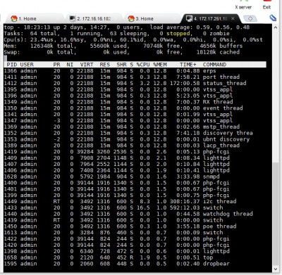

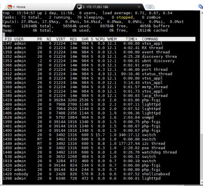

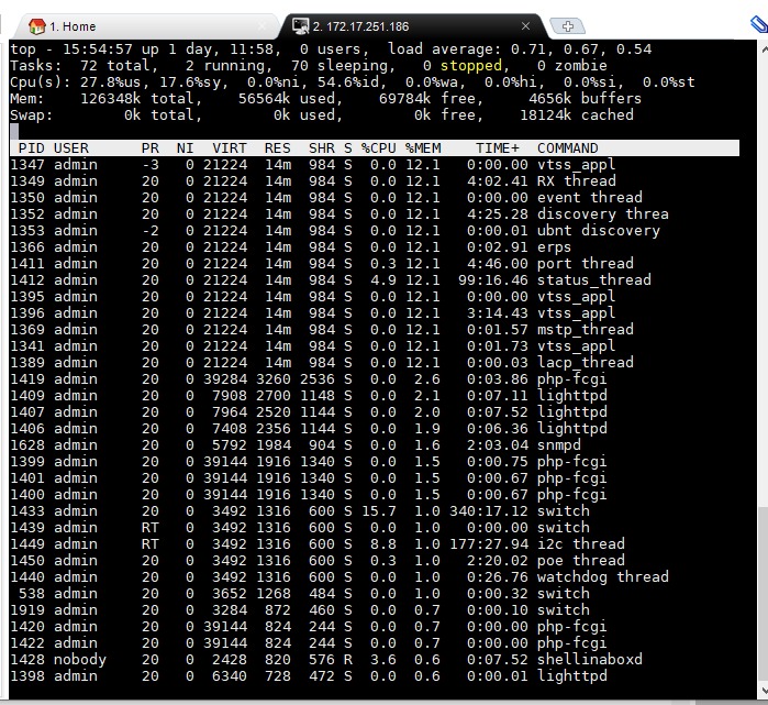

Check the TOP stats we have gathered.
yesterday 15:55 GMT+2
Today 18:28 GMT +2
