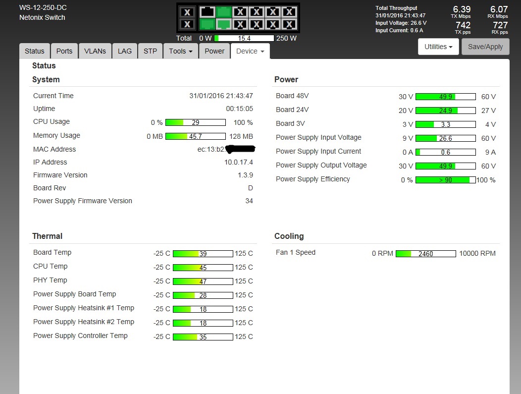

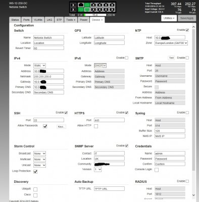

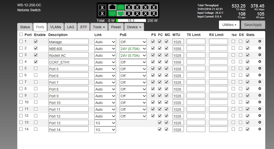

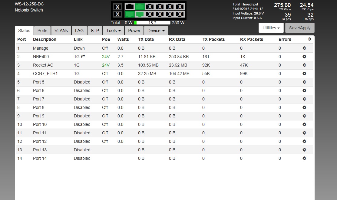

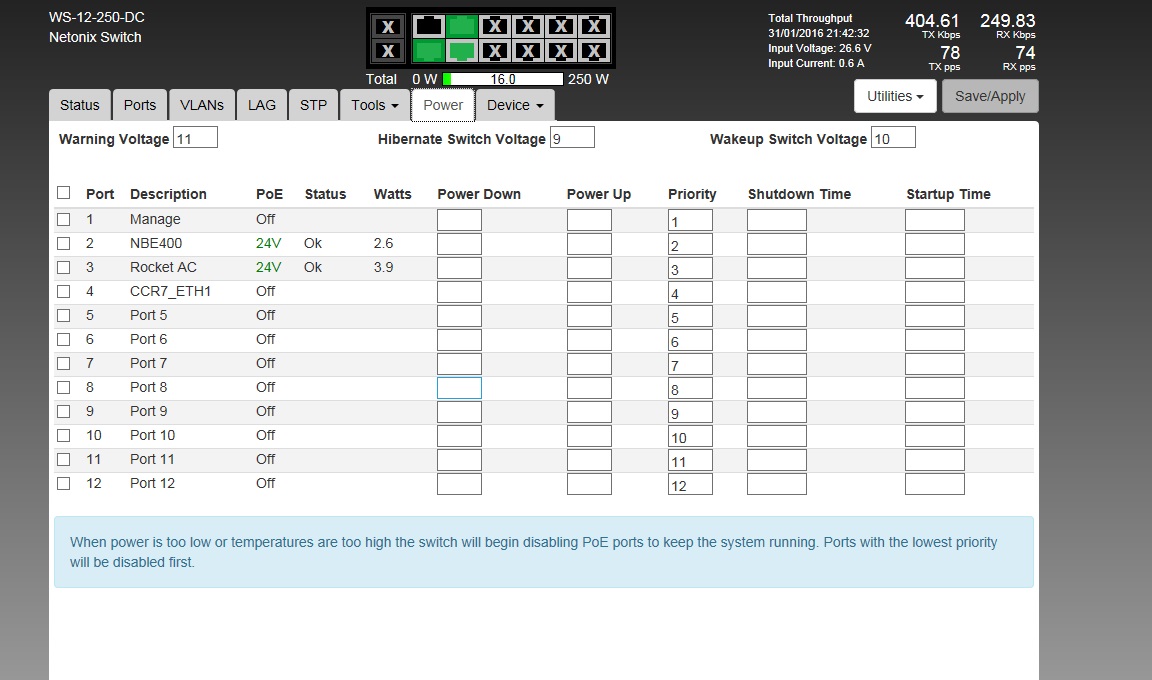

Re: Unexpected reboot and other weird things WS-12-250DC
What firmware version were you using?
1.3.8
What are you powering it with?
A Dycon 2403 switch-mode power supply charger at 24vdc which has 2 12v 7ah batteries. This PSU model powers most of my sites.
What are you powering?
1 x PBE-400 and a Rocket AC Lite
Do you have any SFP plugged into the switch?
Not using SFP
Here are the tabs
As you can see its a simple setup. The switch uplink is from a CCR connected to port 4 which has a fibre backhaul connected.
The PBE-400 is connected to another tower. The CCR runs OSPF and prefers the fibre, but fails over to the PBE-400 is fibre fails.
Customers are connected to the rocket on port 3, PPPOE which is converted to EOIP and run over the OSPF network.
Let me know if you think any config needs changing the switch actually works fine apart from the crashing.
