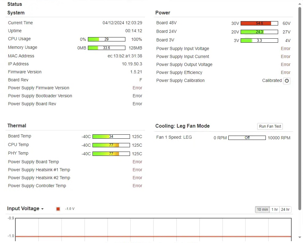

In device/status all information about the power supply is in "Error" status, Input voltage is at -1V but board power is reported correctly.

This is a screen of /Device/Status:

Sorry, I have posted the screen and I haven't noticed your reply.

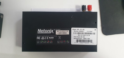

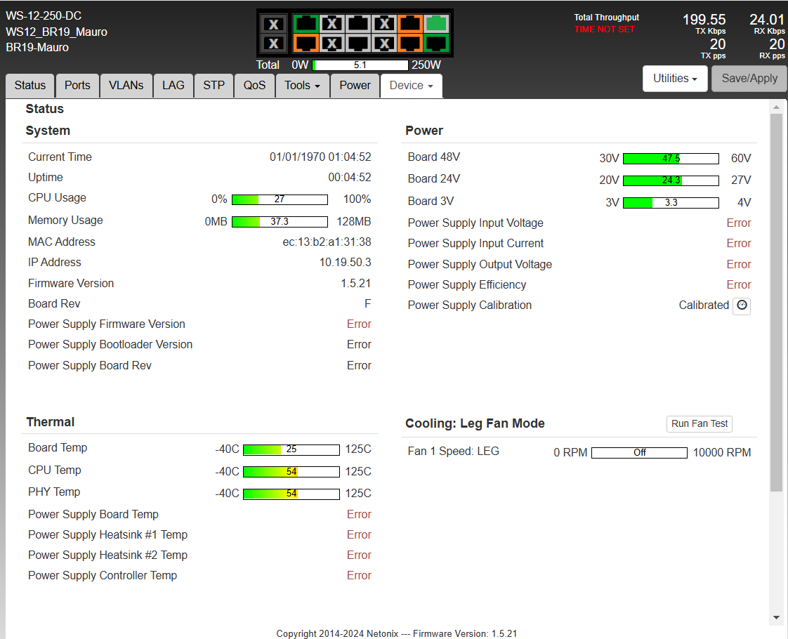

The MAC: in your pic is ec:13:b2:a1:31:38 which says it is a WS-12-DC not a WS-12-250-DC
We sold and shipped that unit to VARIA System GmbH on 03/28/2017. You can get this info from the RMA portal by plugging in the MAC address.
It would help if you did not cut the top of the screen off so we can see what the switch thinks it is (model), please repost pic showing top of UI.

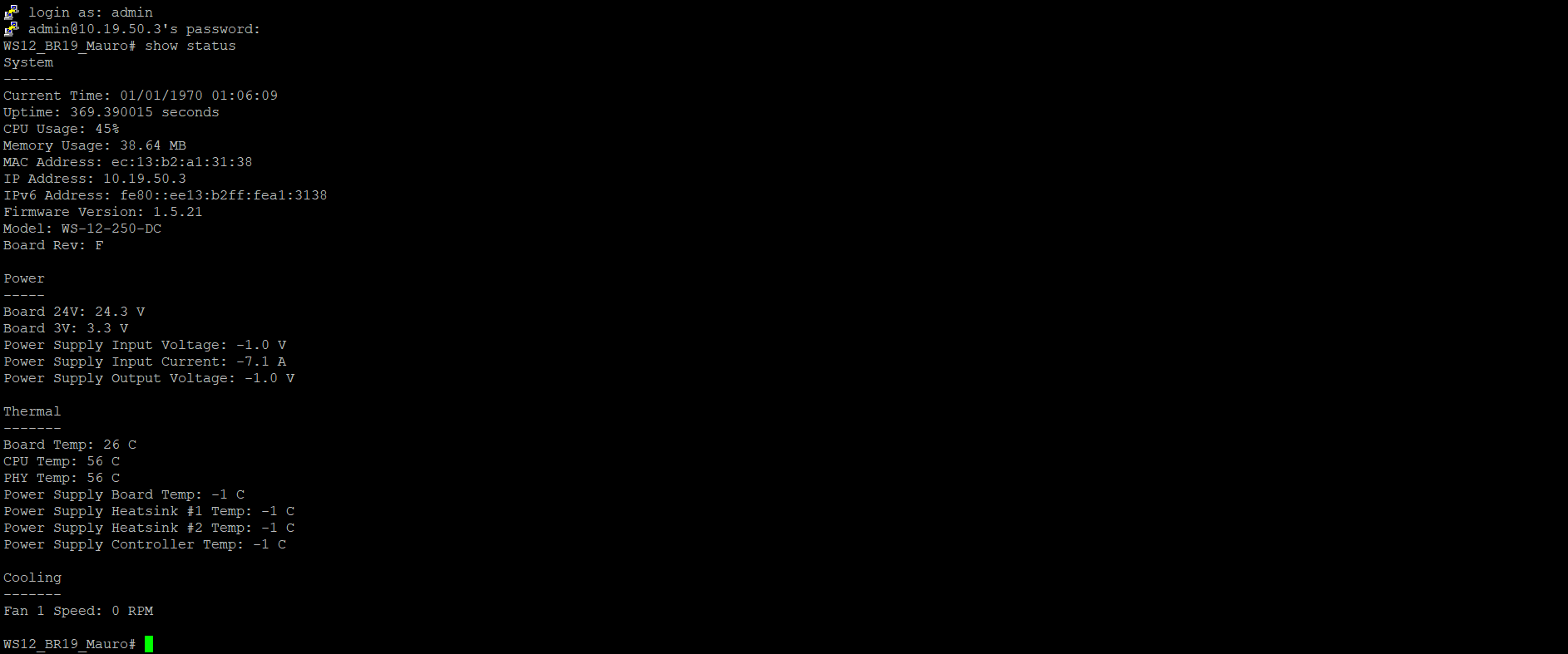

If you go to the console via SSH or in the UI and use the "show status" command can you give a screen shot of that as well.

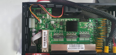

If you can open the switch and provide a pic of the board showing the serial number that would help figure out what happened.

Yes, it is a WS-12-DC. I read the model from the UI rather than from the label.
I attach:
switch labels (The black one on the left is the original and the white one on the right is the one that came with the replacement board):
Labels
Switch board photo:
Board
UI status page:
UiStatus
show status command from SSH:
sshStatus

So looks like someone screwed up on our end.
The good news is I can fix this remotely.
Pull unit from service.
Setup on bench with a public ip or behind a public IP nat with a port forward so I can SSH into it.
Send IP or IP of NAT with port forward to SSH PORT so I can SSH into it. Also user and password.
You can send info to chris@netonix.com
I will login to it and resetialize it as a WS-12-DC and not as WS-12-250-DC.
