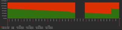

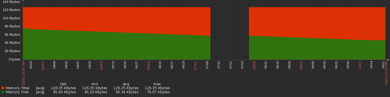

I haven't found this reported on the forms for the 1.4.9 firmware, but I believe there is a memory leak somewhere.
I've got a few WS-12-250-DCs across my network and I'm seeing the free memory all both of them slowly drop over the period of about 10 months.

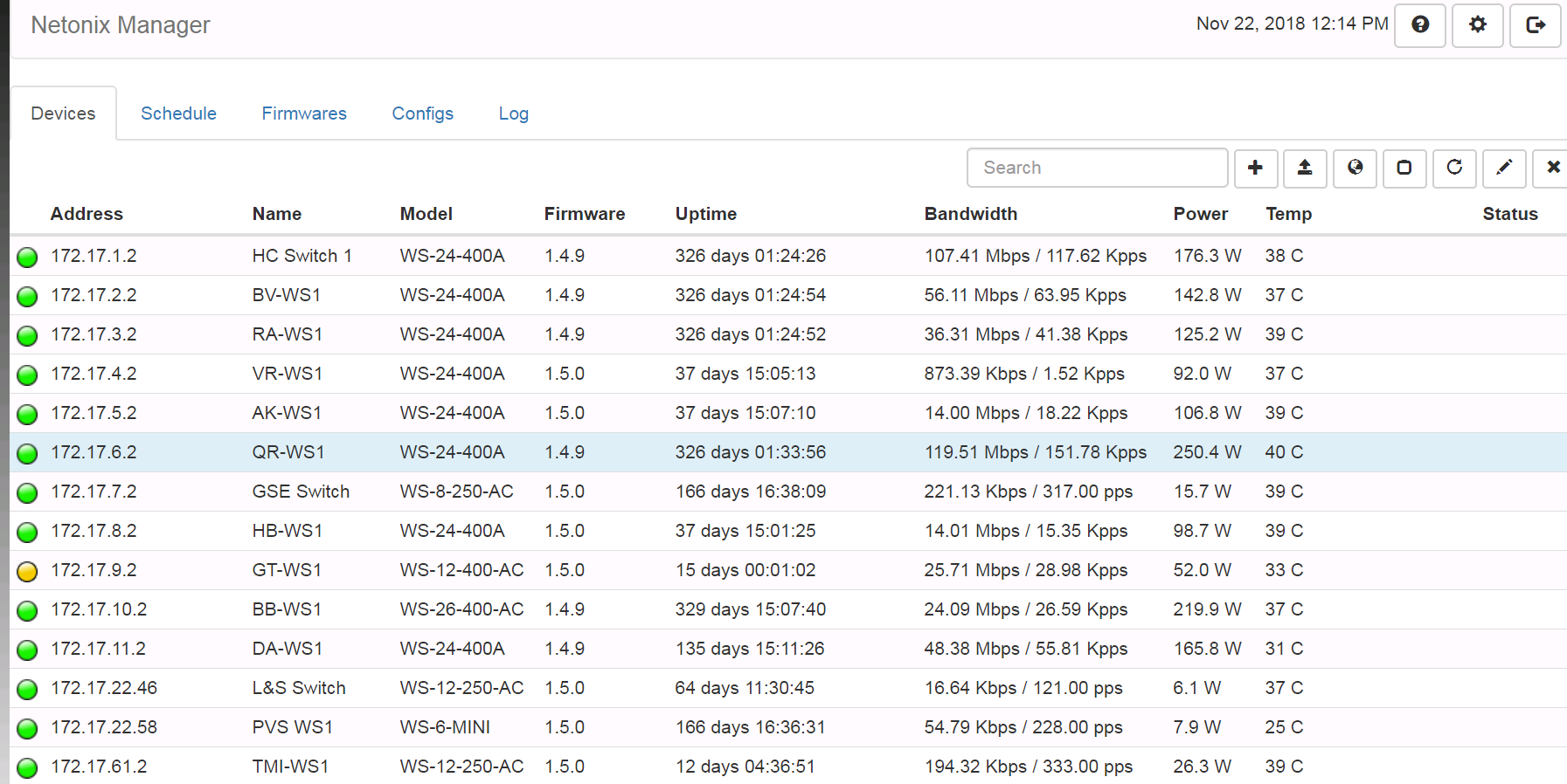

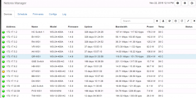

Well considering we are on version 1.5.0 or v1.5.1rc7 try upgrading the units and see what happens.
v1.4.9 is closed an no further development will occurr. However a lot of people are using v1.4.9 and not reporting this.
Also there are security holes in v1.4.9 so maybe if your switches are accessible by web they are hacked?
I have some switches using v1.4.9 that have been up for over a year.
