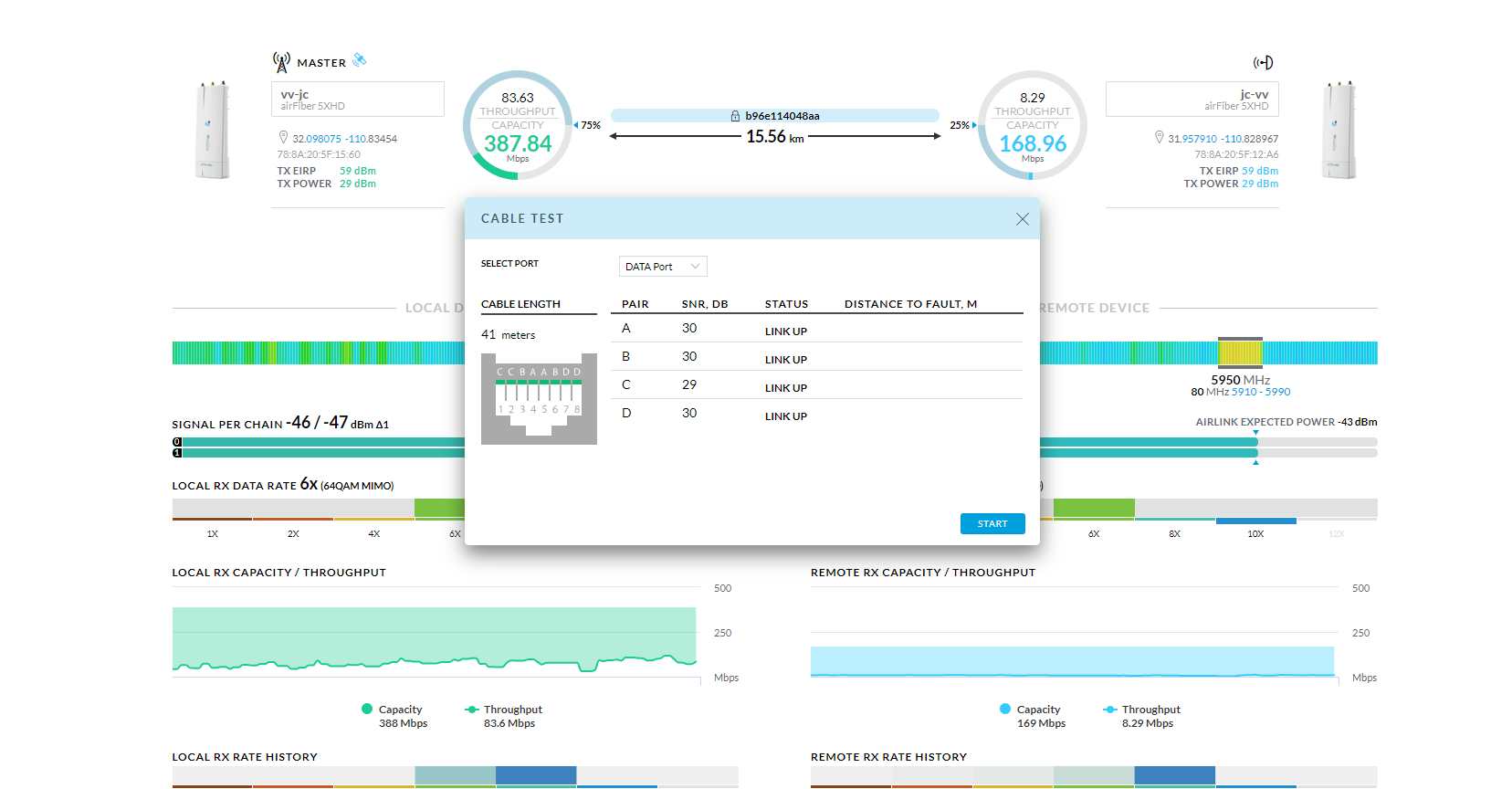

Here is a screen grab of the equipment while power on we will need a tech to go on site to see what the cable test shows when powered down.

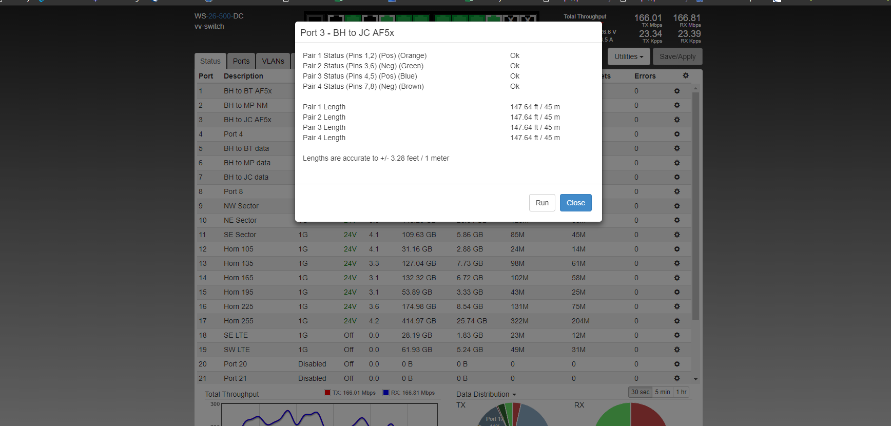

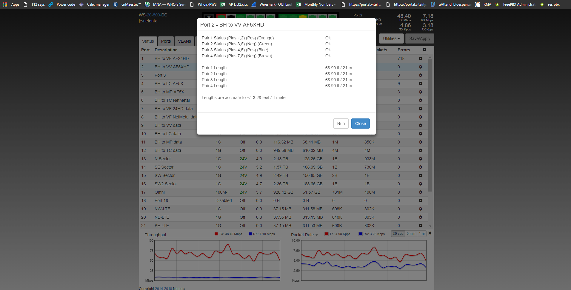

Show me screen grabs of the other side
Re: AF5XHD short on WS-26-500-DC
Here are pictures of the other end of the link.
