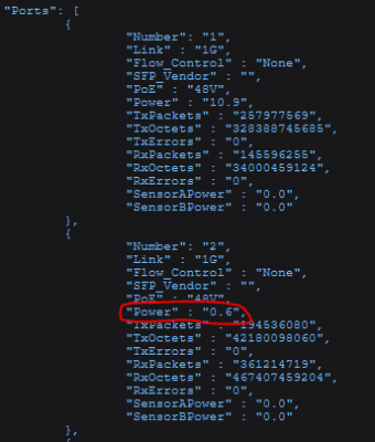

I upgraded 2 WS-12-250-DC hoping to fix a couple issues Based on these 2 changes
- Boot up now performs a gratuitous ARP broadcast, which prevents the scenario where upon a warm or cold boot (aka firmware upgrade, etc) where loss of connectivity
to the switch's management site or ssh access occurs even if sometimes otherwise the switch is operating. - rc2
- Fixed issue, upon boot or config changes, PoE wattage values would disappear on smart DC switches if i2c to the Power Supply failed. - rc2
1. I would occasionally lose access to the switch requiring a truck roll to plug a laptop into an open port on the switch. Once the laptop was plugged I would be able to remote into the switch again. After the upgrade the switch came back and no intervention was needed by the tech on site so that looks good. However The Total Throughput numbers and tx/rx data no longer update unless I refresh the screen. I have tried this in Chrome and Edge
2. On the 2nd switch I have port with a Cambium PTP550 plugged in and powered by the Netonix. The port shows 0 Watts power draw. Upgrading to 1.5.5rc2 did not resolve this issue. On this switch I do not have the Total Throughput number and tx/rx issue that I have on the first switch. Both switches have the same boards
Board Rev F

Issue 1 appears to have resolved itself so at this point it looks good.
Issue 2
Attached the dev console and JSON screenshot. This wattage display issue only is on one port which is port 2. This does not occur on every port, and it does not follow the device when it is plugged into another port.
Issue 2
- Posts: 1076
- Been thanked: 207 times
Re: v1.5.5rcX Bug Reports and Comments
Ahh, it's working on my WS-12-250-DC on that port, so it must be a bad port sensor. My suggestion is to RMA the unit.
