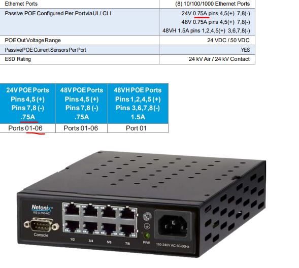

I'm looking at the WS-8-150-AC and I'd like to confirm the max current per port.
On the datasheet on pg. 12, it's stated 24V 0.75A, same thing on the table for ports 01-06 only (see attached WS-8-150-AC-ws-specsheet.jpg)

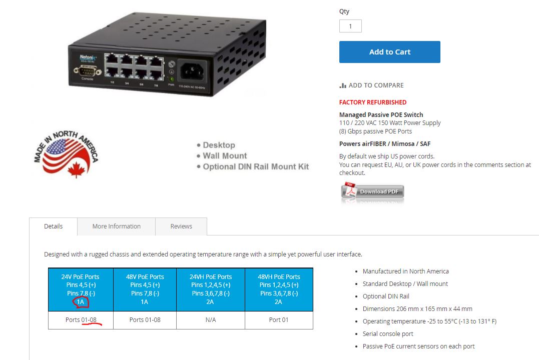

However, on the main page, it shows 24V 1A on ports 01-08 as per the table (see WS-8-150-AC-main-page.jpg).
Please kindly confirm if ports 01-08 are 24V 1A or otherwise

So that has been a debate here and recently we decided to change it to 1A
1A is the maximum but we were afraid that is we put 1A people would push 1+ amps so we had it a .75A to give safety margin.
I just recently went back and changed all the web store values and have yet to go back and change the spec sheet.
So V ports are 1A and VH are 2A (provided the device takes power on all 4 pair like an AF)
24V is 24 watts or 1A
48V is 48 watts or 1A
24VH is 48 watts or 2A
48VH is 96 watts or 2A
Also keep in mind 48V and 48VH can vary between 48 and 50 volts.
Also keep in mind with the WS-8-150-AC we do not report watts per port so you need to calculate watts used and take into account cable length (loss).
