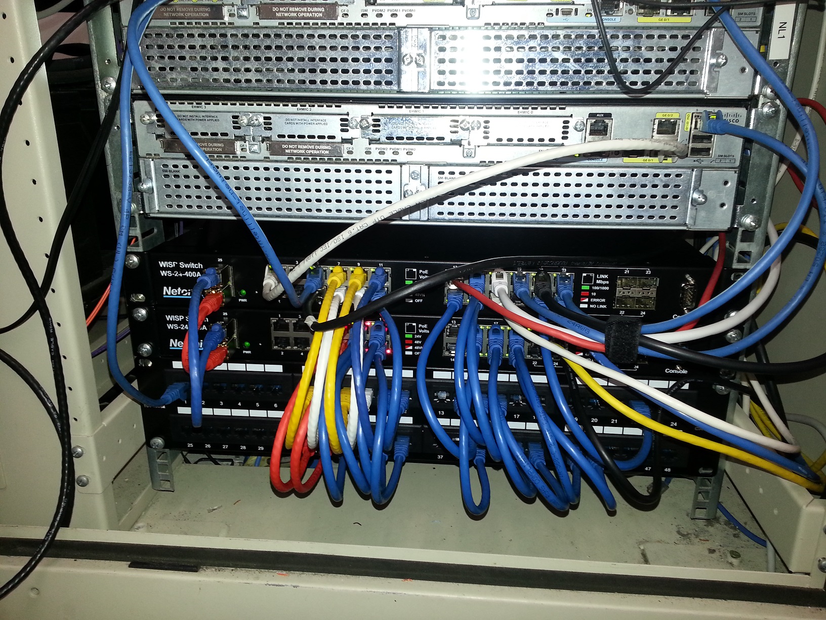

So I had 2 switches in my office rack which I posted a picture last week with a cable MESS. We went back and finally after 15 years put in a patch panel and cleaned it up a bit.
We are busy trying to get the firmware ready for release as soon as possible.

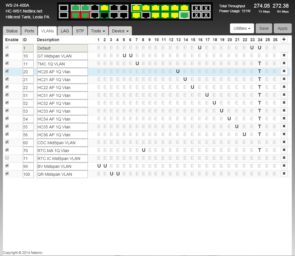

We are working on an issue that appears to be VLAN related. Sadly I have no ETA at this time to solve this issue, could be today, tomorrow, or next week? :headb:
Here is a switch currently in service at one of my towers that we are using to debug the VLAN issue.
It has 2 airFIBER 24 GHz backhauls and 10 airMAX radios.
load tower.png (142.17 KiB) Viewed 34652 times
