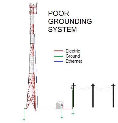

The problems above in order of importance:
The tower ground rod/system is separate from the service ground rod/system. If the tower grounding system and the electrical service ground system is separate the Ethernet cable running to your tower radios becomes a path for the ground potential differences. This often will cause your radio to lose it's Ethernet port yet the radio side continues to function normally. To bond these two ground systems either use #2 green for above ground or #2 tin for below ground.
The tower has only one ground rod. Personally I like to have 3 or better yet 4 ground rods for the tower as far away from each other as possible and in different directions like N,S,E & W and bond them all together. If driving the ground rods below the surface so as not to cause issues for lawn mowers I then trench between them so as to bond all of them together and always use CAD welding and #2 tin for below surface connections.
There is no direct ground wire run up the tower to a copper ground bus bar near my antennas with #2 green ground wire so I can ground each antenna to the ground bus with #6 green ground wire and lugs. Remember electrical current takes the path of less resistance and the steel tower is a higher resistance than your copper Ethernet cable. Now #2 green copper wire has a much less resistance than 24 gauge Ethernet.
The shelter Electrical Service only has 1 ground rod, you need at least 2 rods or even more as far apart from each other as possible then bond them together.
Lastly the power company is supposed to have an Earth ground rod at the base of every pole that has a transformer but often the crew is lazy and just throws a ground rod in the same hole as the pole when they set the pole. To make things worse most poles are only set in the ground 4-6 feet which means the ground rod never reached the clay sub-soil and thus is a poor ground. This can be a problem if you have a good grounding system on your site because now your site's grounding system may be the best path to ground for a large area around your site and attract stray voltages from the surrounding area. I do not condone this but I personally often go to the pole that has my transformer and drive in a second ground rod a few inches off the pole being careful not to hit any underground utilities like gas or water lines then I bond the two ground rods together providing a good ground path before entering my site.

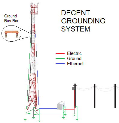

Below is an example of how I would improve the site grounding system.
CLICK IMAGE TO VIEW FULL SIZE
I have not lost a single radio in the past 4 years on any tower and I do not use any Ethernet surge protection on my tower sites. I do have Trip-Lite inverter chargers that have electrical surge protection.

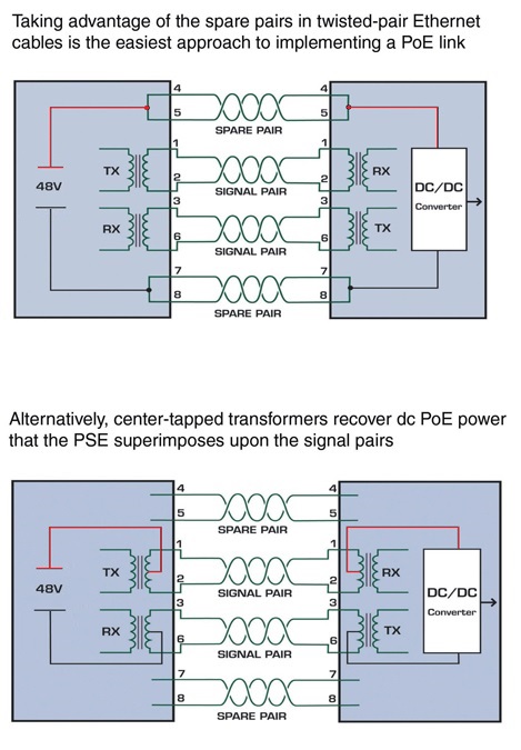

To further make things worse early 10/100 wireless devices did not use POE Center Tap Ethernet Transformers but instead just hard wired the extra 2 pair as the DC feed to the remote device.
Now this in itself was not a bad idea until they did not use 1500V isolated power circuits which means that often the AC Earth Ground was bonded to the DC Negative circuite. This would then also be connected to the outer conductor of the SMA jumper which is also connected to your antenna which is in turn connected to the tower and thus the Tower Earth Ground System. This meant that the tower now had a direct connection to the radio DC negative that is now connected to the POE switch DC negative source.
This is yet another reason it is IMPORTANT to insure tower grounds are bonded to electrical service grounds.
