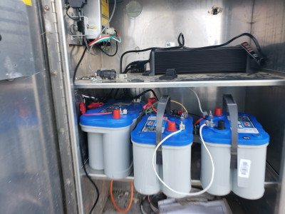

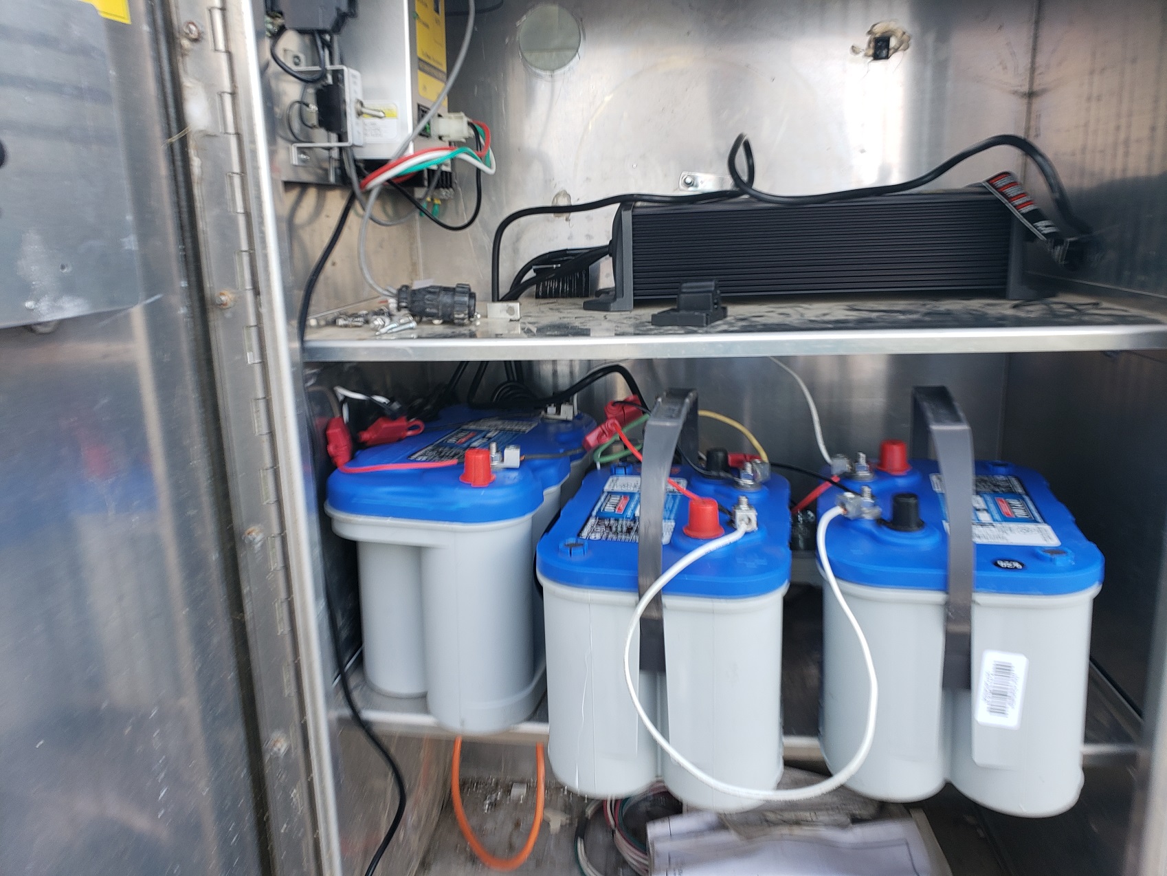

Here is a pic. I had issues with the size. Hopefully you can see what you need to see.
Thank you

Re: Batteries
#1 - are the bateries 12 volts and it looks likeyou have themin series to create a 36V system
#2 - how are you charging them, whare are the specs of the charger (volts and amps)
#3 - since you remove a battery are you using a differenty charger now?
#4 - thoose wires seem very thin what is the guage?
- talleytech
- Posts: 10
- Joined: Mon Mar 21, 2016 9:41 am
Re: Batteries
The Charger is Minn Kota 330. 30 amp, 10 amp per bank. Yes you are correct 36 volts now. Optimus 55 amp hour. I was doing 48 but couldn't get a new Minn Kota 440. II think the issue is the heat. I noticed that during the day the voltage drops. The cabinet has a fan but it still gets pretty warm. I am going to put the new 440 on the outside of the cabinet and see if that helps. The jumper wires are solid 12 gage. The ones going to the switch is stranded 12 gage. The cables are not getting hot but I can make some newer jumpers if you think that would help. Thanks for the help. FYI I did mount the Maintainer on the outside at another location and that does seem to help.
