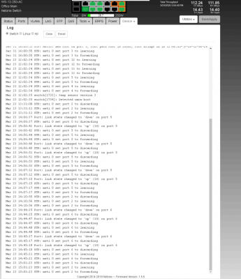

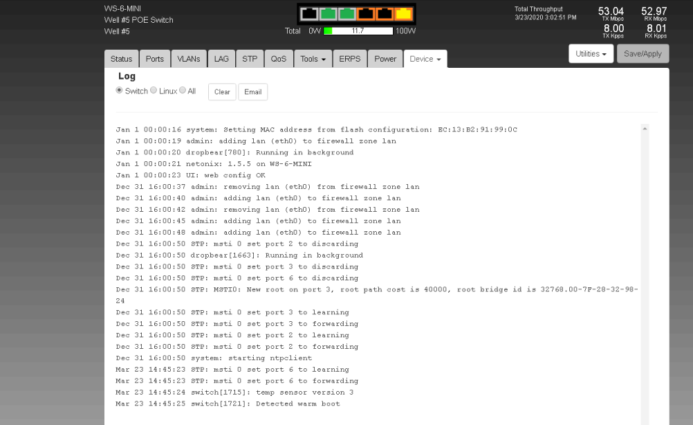

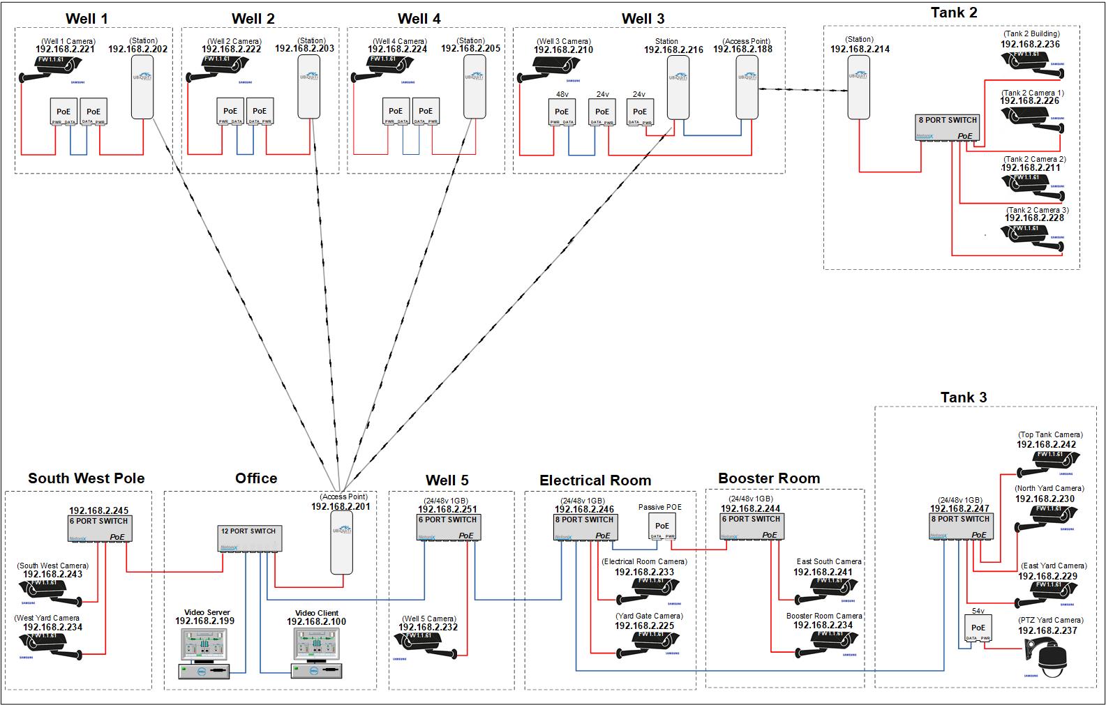

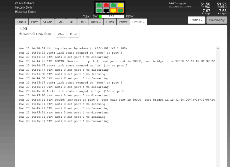

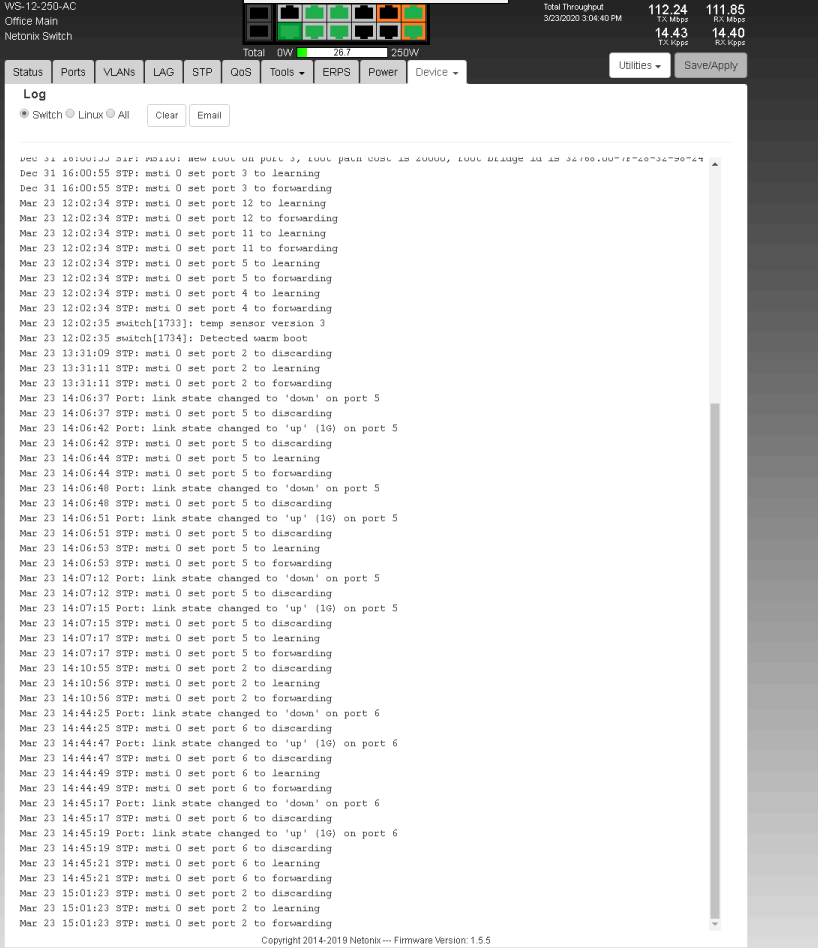

Hi guys,
I would like to know whats the best configuration for Netonix switches that are all linked together? Do I need STP enabled on switches that are connected directly to each other? I attached some of the logs that show a lot of STP activity and I do see disconnection from time to time. Is this normal? Is there a possibility that the Netonix switches are blocking port 502? For some reason, I can't read that port anymore from the office computer but when I connect to the device locally it reads fine. Sometimes we have to cycle the power on the switch and we're able to read port 502 again. Any thoughts?

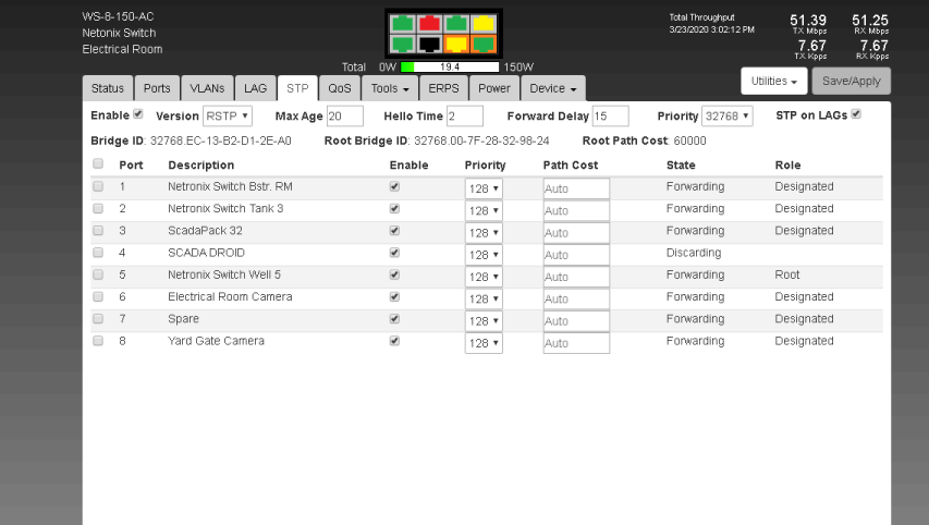

Well best to start with the simple stuff first.
Just reading the logs and looking at your setup. I don't think port 502 is being blocked exactly. It's more likely you're probably routinely losing access because a different link's cycle their connection, then when it comes back up, STP has to disable it, re-converge and enable the correct port again.
So disabling it (in areas where there is no loop on the adjacent switch) would probably give you better access.
But the real question is why are the ports going down. From what I see in you're setup it could be as simple as just disabling flow control on all the switches. It has been known to cause trouble like this with links over radio because as the carrier signal fluctuates, the capacity varies and can confuse the flow-control feature and cause it to stop the link's temporarily causing "spurts" like this.

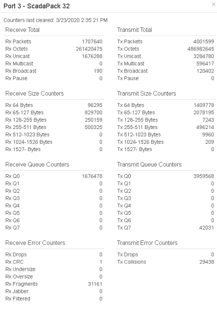

@stephen

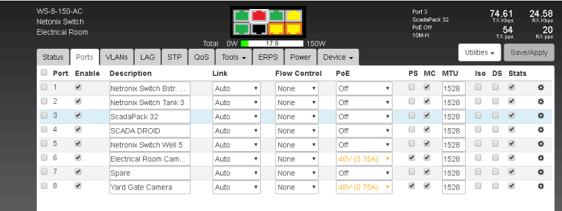

After turning flow control off on all devices. I'm now showing a lot of errors on a device? Any advice?
Here's some pictures

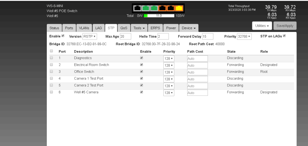

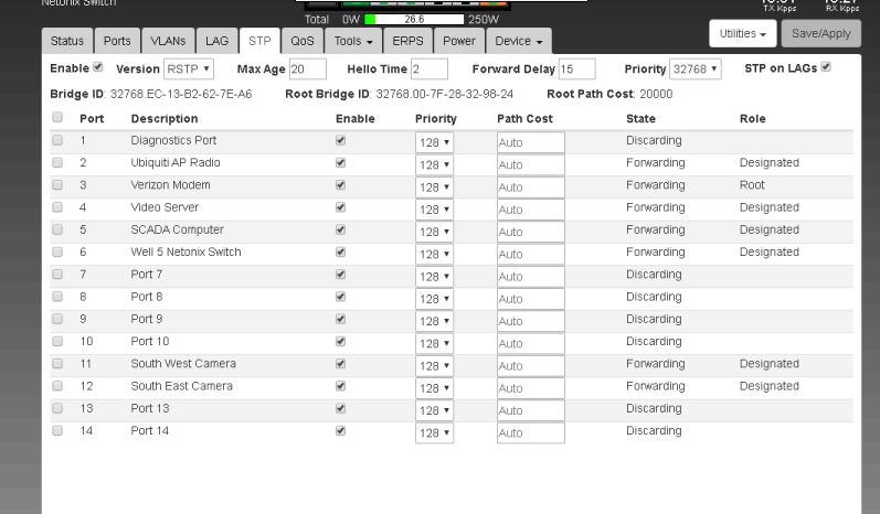

Well we may need to know a bit more information.
Are there any VLANs besides the management VLAN?
Re: Best way to configure this network? STP Log Issues?
Stephen wrote:Well we may need to know a bit more information.
No VLAN configuration on any of the switches. STP configuration has been left as default. No changes have been made to them.
fvelasco wrote:After turning flow control off on all devices. I'm now showing a lot of errors on a device?
You don't see error, you see fragmented packets and collisions. The collisions are probably you problem.
Those happen when the speed and rate are not the same on both side. It often happen when one side is autoneg and the other, forced to a speed and duplex. Force both side or leave both side at autoneg.
Fragmented packets is not an error but could lead to performance issue. Make sure you MTU is high enough on every devices.
