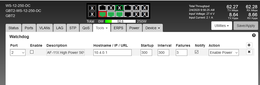

Re: v1.5.5 Bug Reports and Comments
Stephen wrote:RebusCom,
As you can see, on your log's it just say's action is "Bounce" not "Bounce Power" or "Bounce Link". I believe what has happened is that maybe the firmware you upgraded from may have only had the option to "Bounce" as I recall we separated this into Bounce Link and Bounce Power later on. If in the internal storage of the switch it still shows the action is "Bounce" then it will no longer recognize that option and nothing will happen.
To correct this, try deleting that watchdog, saving your configuration, and then re-create the watchdog and save again. This should correctly update the conditions on the switch. Then monitor the logs, if you don't see it look similar to the bolded statements in mine, aka, "Bounce Power" or "Bounce Link" then let us know here.
Upgrade was from v1.5.0 to v1.5.5. Following upgrade the watchdogs were all reflecting the desired Bounce Power, matching the previous functionality in v1.5.0. However, the behavior was not in alignment with the setting in the GUI, bouncing the link. It worked properly in v1.5.0.
I've done as you suggested toggling the setting in the GUI which will hopefully clear up the problem but I'm really surprised I'm the first to encounter this issue. There may be a lot of switches out there now with hidden watchdog misconfiguration.

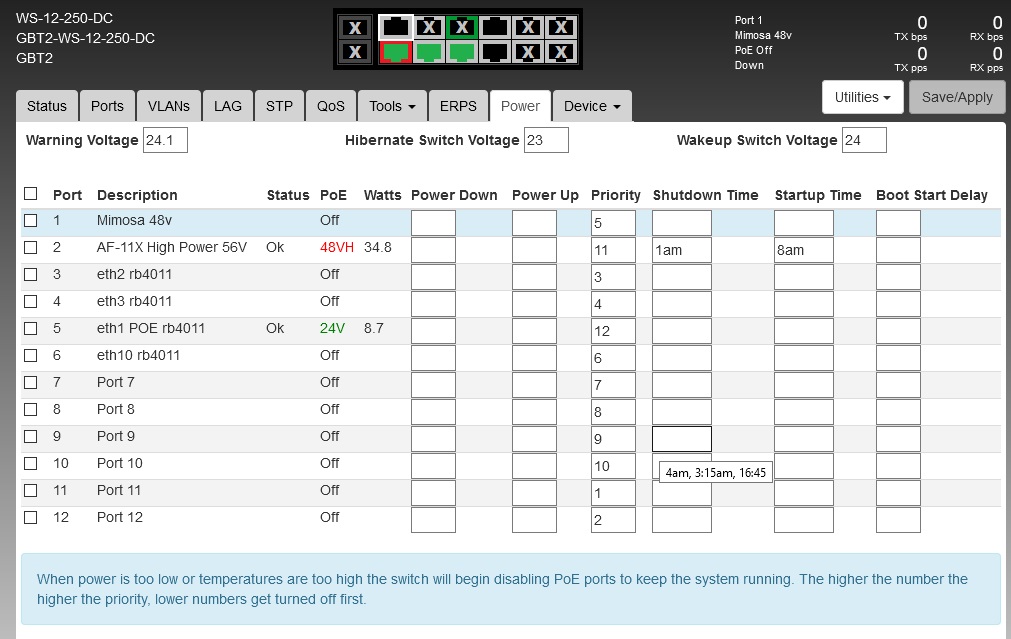

Port 1 shuts down 1-8am, then comes up, a few minutes later it shuts down and is stuck down, no power draw, yet the GUI says it is on:
This all started happening after I tried using Watchdog to power up the port 1 if during the 1-8am period, a ping failed.
Tried bouncing manually, acts the same, reboot only way to clear apparent "on" port1

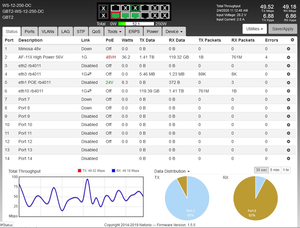

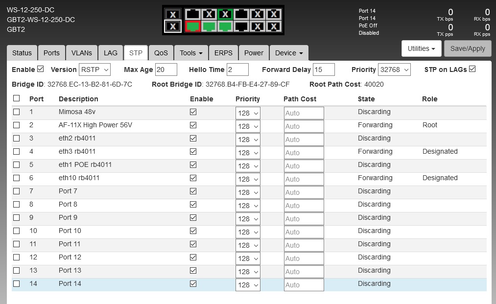

Please post your Power, Status, STP, and Watchdog tab. I need to replicate the behavior.
