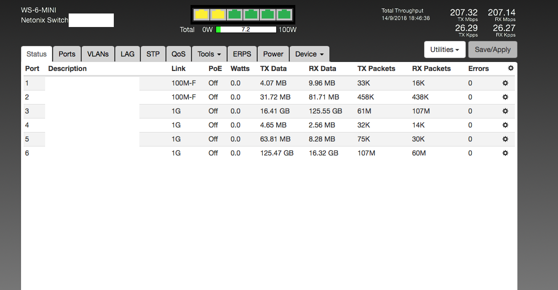

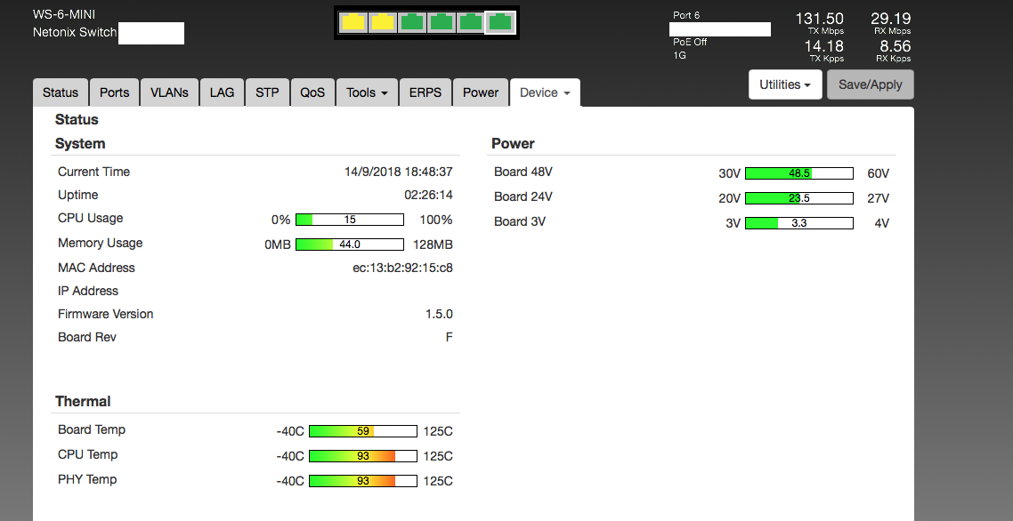

Can you post up these TABS: Status, Ports, Device/Status (see my post footer on how to properly upload pictures)

Screenshots uploaded.
