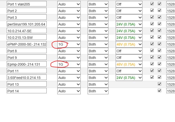

switch stays up, ports show lit, but no traffic to ap.
happened twice last week, now twice this am.
Rebooted ap's with netonix by turning power off and back on and traffic was resumed, (port bounce did not work),
Suspected spanning tree, but it has been disabled and still happening.
2 other Canopy 5750ap's kept pinging and passing traffic,
When this happens you cannot ping ap from switch,
found if I lock the port at 1 gig, it starts passing traffic again with no reboot of ap,
any clues?
have about 40 netonix switches, this is only one that I know is doing this,
WS-12-250-DC Stopped passing traffic to ePMP-AP's

Yes, do NOT set port speed to 1G leave set to Auto
If you hard code a port speed to 1G and the communications needs to migrate down even for a second it can drop the connection.
When you reboot the radios you cause the link to renegotiate and it achieves 1G but if the right events occur the link can be dropped since it can not auto negotiate down if needed.
Also note that if you keep up on our forum that a few people had reported a similar issue with Flow Control with ePMP 2000 radios
So, I would:
1) set port speed to Auto - NEVER HARD CODE PORT SPEED EXCEPT IN EXTREME RARE CIRCUMSTANCES
2) if you still have issues then disable Flow control on the ports facing ePMP radios
So, I would:

I disabled flow control and radios came right up,
Re: WS-12-250-DC Stopped passing traffic to ePMP-AP's
tcknudson wrote:I disabled flow control and radios came right up,
I am sorry that does not prove the problem is NOT the hard coded 1G speed and Flow Control may have nothing to do with your problem.
When you disable Flow Control is causes the Ethernet connection to be dropped and then renegotiate.
Please do it in the order I asked:
1) Set port speed to Auto and leave Flow Control ON - NEVER A GOOD IDEA TO HARDCODE PORT SPEED DUPLEX
2) If it still happens then disable Flow Control
