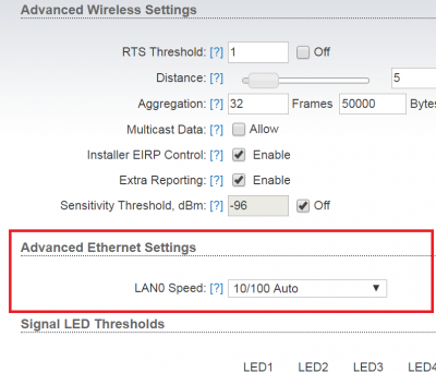

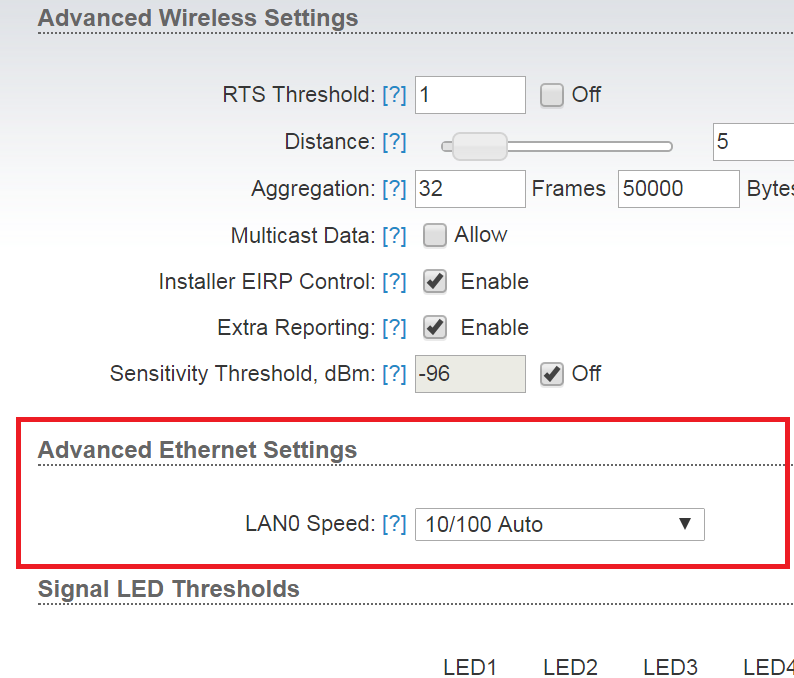

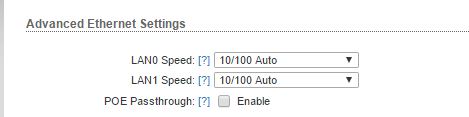

Trust me in the UI you can set speed/duplex
With airMAX M series it is under the ADVANCED Tab
It is also a setting in the UniFi UI or Controller UI
If this is set to 100M only this is your problem.

Yip... on the air Max devices its 100% there and i get that...
This is the same config on all my radio's BTW

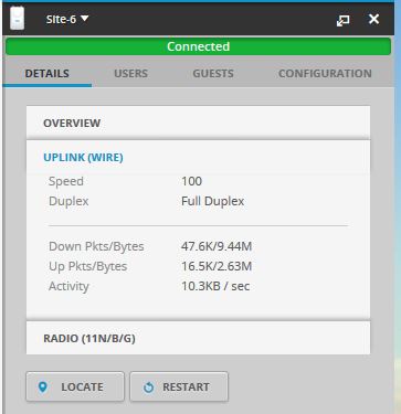

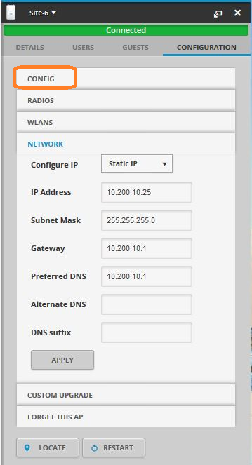

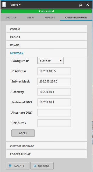

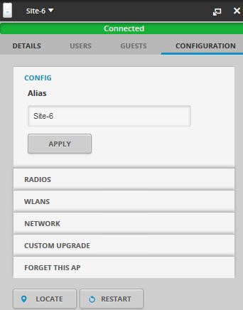

but it doesn't existing on the Unifi controller... feel free to prove me wrong...
Re: WS6 Mini - port state chnages every 30 secs or so

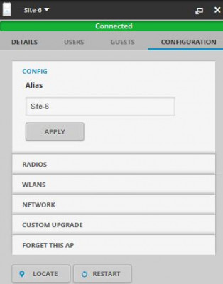

Whats under here?
rodrayner - Member
- Posts: 25
- Joined: Sun Dec 27, 2015 7:46 am
- Location: Hinckley, Leicestershire, UK
Arrhh.... that just the name of the AP...
