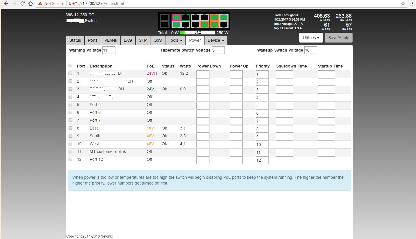

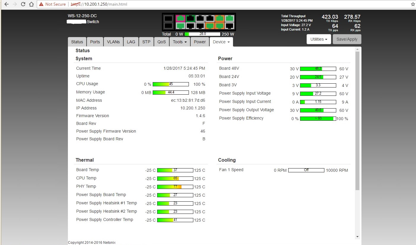

Please post up your Device/Status Tab and Power tab
To upload pictures use the Upload attachment link under blue submit button

Re: ws-12-250dc turned off and didn't turn back on.
Thiink I did that right
