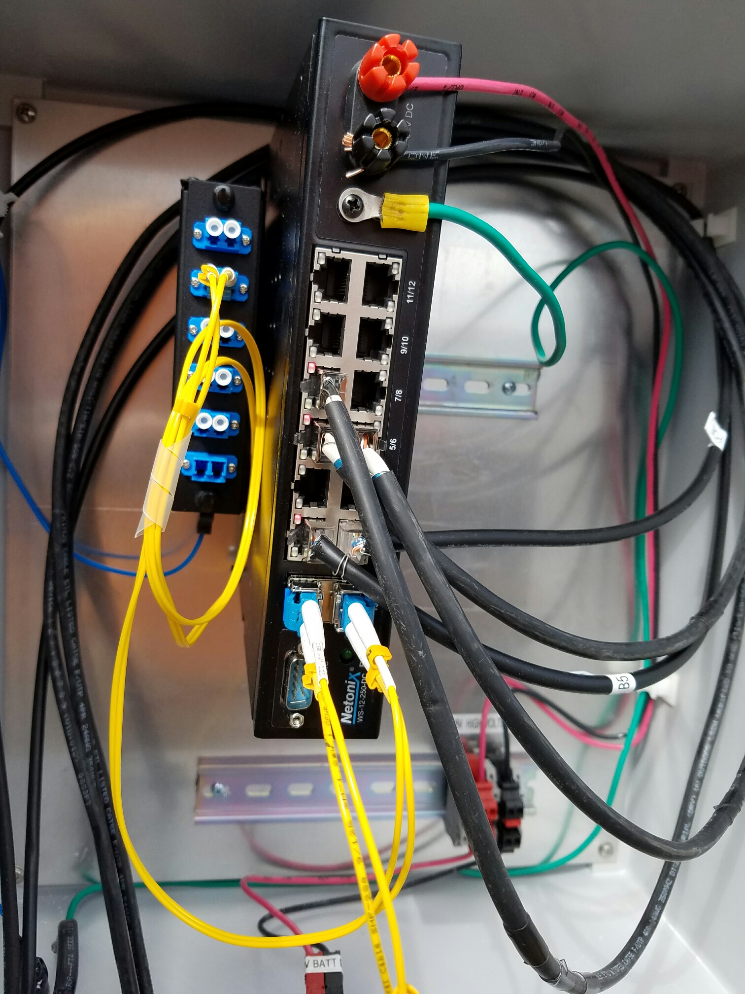

I have a new dc 12 port 250w switch that we installed less than a week ago, then Saturday morning the site was offline. i went to the site and noticed the switch was rebooting over and over again. rebooting so fast I couldn't even get consoled into it. i ended up swapping it out for a different switch to get us running again.
powered by 54v DC

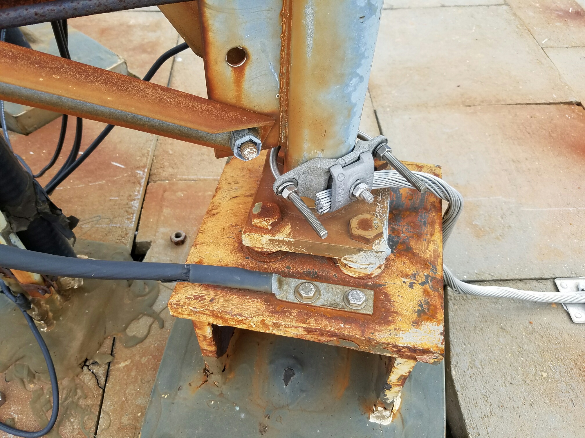

tower and swtich are grounded - fed by fiber from he router.

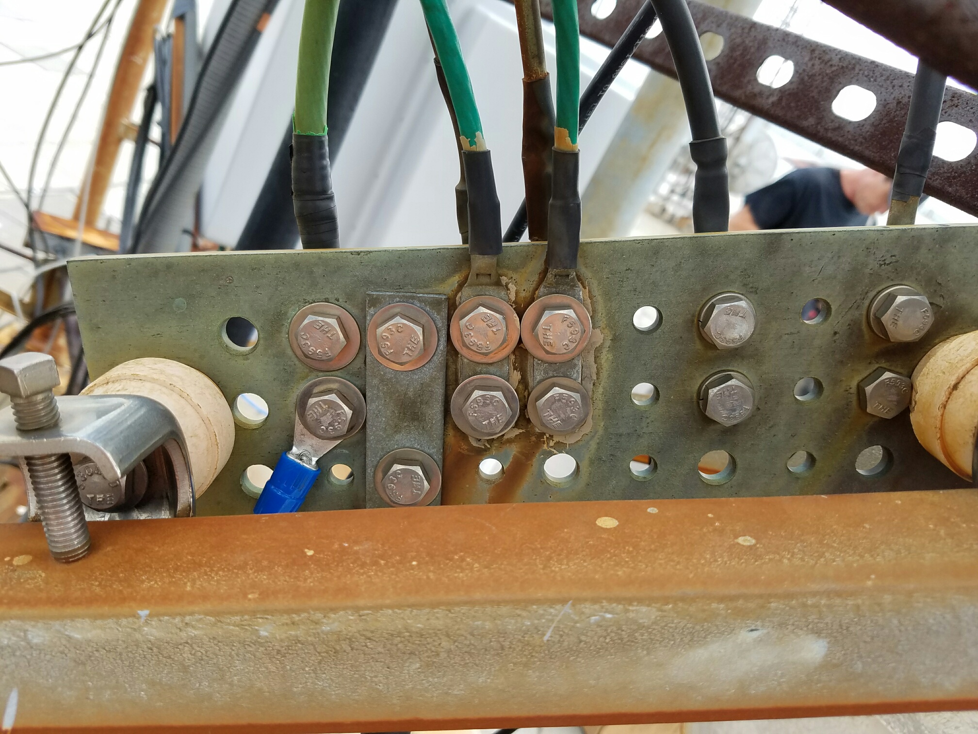

You say tower and switch are grounded but this is a vague description.
Does this site have AC grid power and if so explain where it comes from.
What is the tower and what type of grounding does it have?
If there is grid AC power is its Earth Ground rods bonded to the tower grounding rods.
Do you have a ground wire that is bonded to tower grounds and service grounds running up the tower and then to each radio/antenna, meaning a dedicated ground path other than the Ethernet cables that is shorter and less resistant?
Are you using ESD drain wire Ethernet Cable and do you have a decent service loop to insure its path is longer than intended ground path?

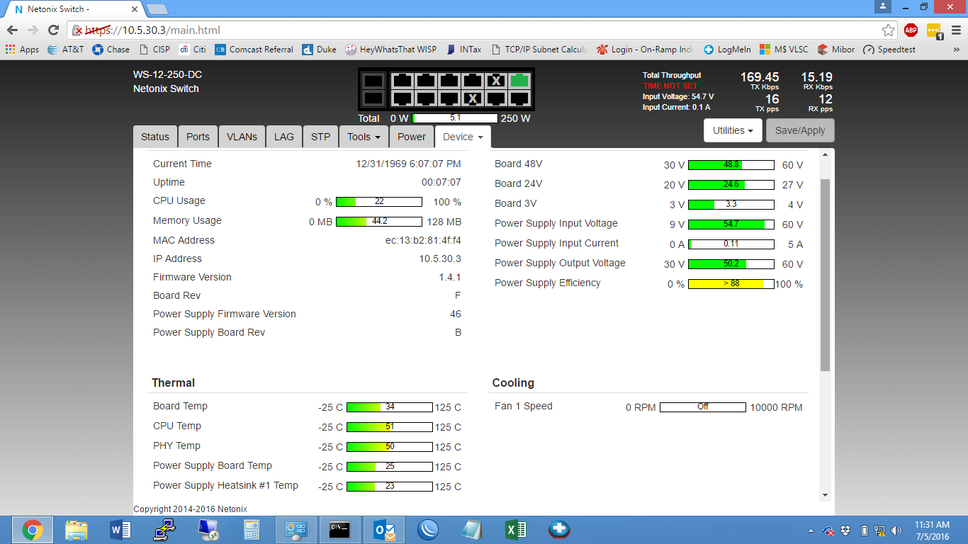

THe first thing I would have done when I arrived was put a volt ohm meter on the power source and watched what it was as the unit was rebooting.
My guess is the unit booted up and started drawing power and knocked the voltage down and it rebooted?

I started seeing the same behavior with switch 2 today at this same site. I completely shut down the tower power. Turned down the DC voltage from 56v to 51v and powered it back up. everything is stable now for the last 3 hours. I also updated firmware to 1.4.2 just now.

we are using a Mean Well AD-155C AC-DC Enclosed power supply with UPS function; Output 54Vdc at 2.7A +53.5Vdc at 0.5A
https://www.meanwell-web.com/en/product ... ct/AD-155C
our rack and routers are indoors about 200' away from the rooftop tower. use srun Dc using 12g wire and 12 strand fiber outdoors to the tower where the switch is located in a top site box, this keeps the Ethernet runs short to the radios.
yes there is 150ah batteries.
Re: REV F Switch rebooting at high RF environment.
slepere1 wrote:we are using a Mean Well AD-155C AC-DC Enclosed power supply with UPS function; Output 54Vdc at 2.7A +53.5Vdc at 0.5A
Looking at this power supply sheet is this what happens?
Meanwell supplies power to switch but also has an input terminal to hook to batteries for backup and the Meanwell keeps the batteries charged.
If AC power drops then the Meanwell draws power from the batteries.
I am not sure why you would use the WS-12-250-DC unit here, you should use the WS-12-DC as you are supplying "conditioned" power to the switch.
The whole idea of the WS-12-250-DC unit is that it expects to be hooked directly to the batteries and deal with a wide range of voltages from 9V to 62 or 72V depending on Rev as the battery bank discharges.
When the switch is hooked to the batteries direct it is getting a nice clean SINE wave of power whereas the meanwell is delivering a modified SINE wave and could also inject noise on the DC line that the batteries would normally filter/absorb.
Also note that this Meanwell is not capable of delivering the required amperage the switch needs (could deliver) as it is only has 2.7A which is a bad idea.
You're not using this model in the application it was designed for, can you hook the switch to the directly to the batteries and just use the meanwell as a charger or get another charger unit not a power supply?
Or swap the WS-12-250-DC with a WS-12-DC which is designed for this type of application.
