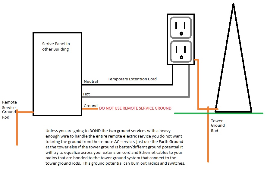

Well this looks to be the final update. The switch has been running for 2days and 17hours without any issues. It has been around 90F outdoor temp and sunny so the issue was NOT heat related. My poor grounding led to the damage of 2 MINIs. I might not go to the same level of grounding as Sirhc recommends, but at the very least I will NEVER have my AC ground and tower ground NOT bonded together.

Tyler was pulling AC power from a house 150' away as well as Earth Ground and the tower had its own ground rods. He will be making a post to confirm this in this thread later today or so he promised me.
Same deal as with Seth's problem above.
I had him do what I had Seth do above (shown in picture below) and Seth's problem was solved but not until he fried 2 WS-6-MINI switches.
Service Grounds and Tower Ground must be bonded or do not use the Service ground if pulling power in such a way from another distant location.
People good grounding is IMPORTANT!
Ground is not ground, ground potential differences equals current and to much current kills electronics even current created by ground potential differences.

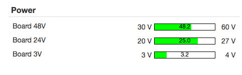

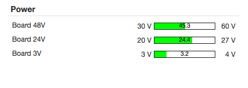

I have a situation where both the mini and antennas (mini tower on a 2" pipe) are grounded to electrical grid only via heavy gauge wire. Electrical grounding was verified to be good and we checked it again today. Mini is powered by a WS-12-250AC (also grounded to same grounding block) via PoE however as of 48h ago we started experiencing similar symptoms to ones described in this thread. There has been no severe weather (not even rain) within last 3 days yet the mini started acting strange. When powering 2x ubiquity antennas it's running fine, adding a third one causes the switch to freeze and sometimes reboot.
When comparing to other minis working in similar environment I noticed that the one that's causing problems does not have stable voltage on the status page:
The voltage fluctuates between 43.4V to 48.8V and between 23.xV to 25.xV

So I've opened 2 new mini, fresh out of a box today, plugged it in to an AirFiber PS (new) and here's the interesting part: one of them has a stable 47.xV on the status page the second one is fluctuating. I decided to run both on the bench with 2x airfiber radios plugged in and 2x powerbeams and for about an hour they ran ok (one with stable voltage one with fluctuating voltage).
After this bench test we replaced the mini from the tower with a new one from the box that had fluctuating voltage, it locked up within 30 minutes just like the old one, so I went back and put the second one with stable voltage on the tower: it's been up for 4h 42m.
I know bad grounding can harm electronics, but being an electrical engineer the above does not make any sense.........the only difference between the minis on the bench is dates when we bought them....on the other hand there's another mini on a tower, grounded to electrical ground only that has been up for 14 days 05:53:51
and looking at the status page, the voltage is also going up and down but it's rock solid.
