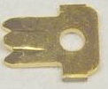

These units will use the gold plated Trident 3 prong connector only made for solid core.
Our other connectors currently use the gold plated Fork 2 prong made to work with solid or stranded but no one has had any issues with our connectors that they had with the original UBNT connectors before they switched to a 3 prong Trident.

The pointy kind are made in two styles. One style has the points in a line and those should only be used with stranded. The other style has the points staggered so one goes on one side of the solid wire and the other goes on the other side. I have never dissected the old UBNT plugs but if you read the thread I linked to that batch appears not to be staggered.

Other other connectors use the what is called the fork contact in this industry which has 2 prongs each slightly angles to go each side of a solid core or penetrate a stranded bundle.
We selected selected the Fork which is used for our normal connectors so it can be used with Both types of wire. We have been selling them for months with not a single complaint.
