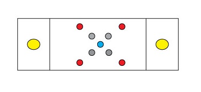

Here is a fast drawing of my idea for a support plate that can me created "easy" if you have some friend with CNC.
P.S. The dimensions are not right btw!
The Grey Holes are for the mounting ball pins.
The Red dots are for the 4 holes of the current clamp.
the Blue hole is for the Balls screw.
And the yellow holes are for an U shaped bolt (like the one used in Powerbeams) to mount on the pole.
The only hardware needed is this plate, 4 nuts with bolts sets to connect the current plate and the U style bolt with two nuts.
I think this way can be bullet proof mount for any Litebeam!

Mikea wrote:@jjonsson
Hi Mike,
Great, but I'm not sure where/how to use it ?
