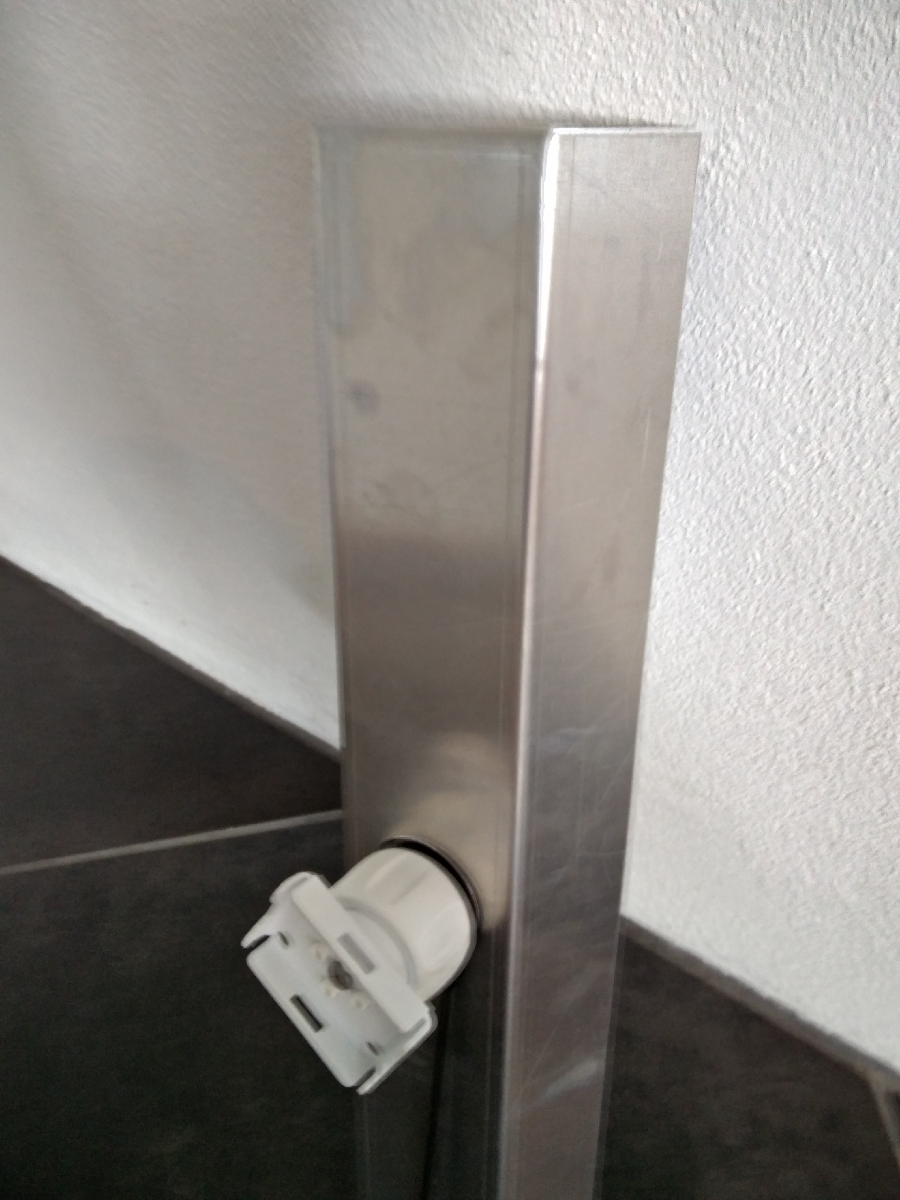

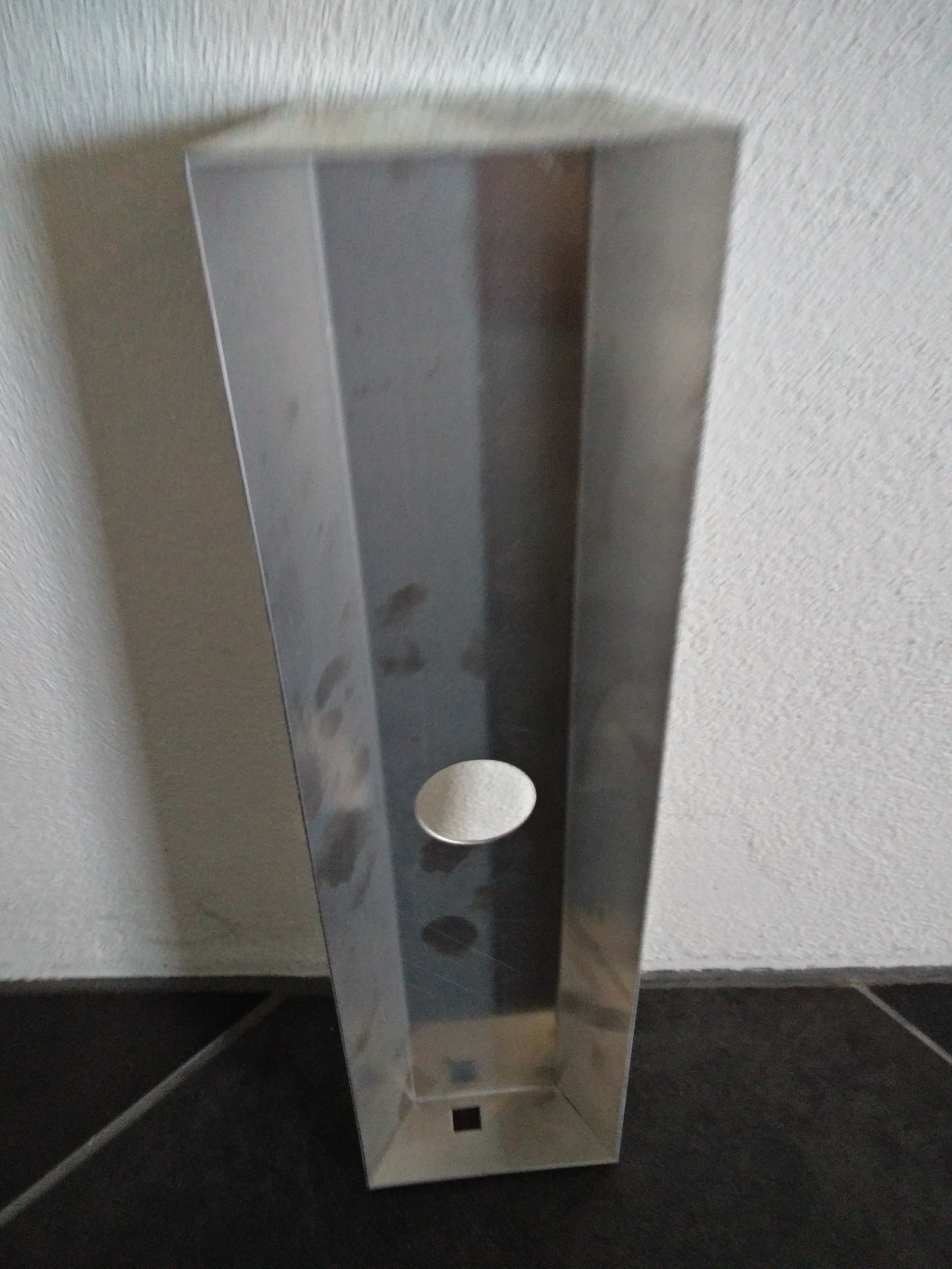

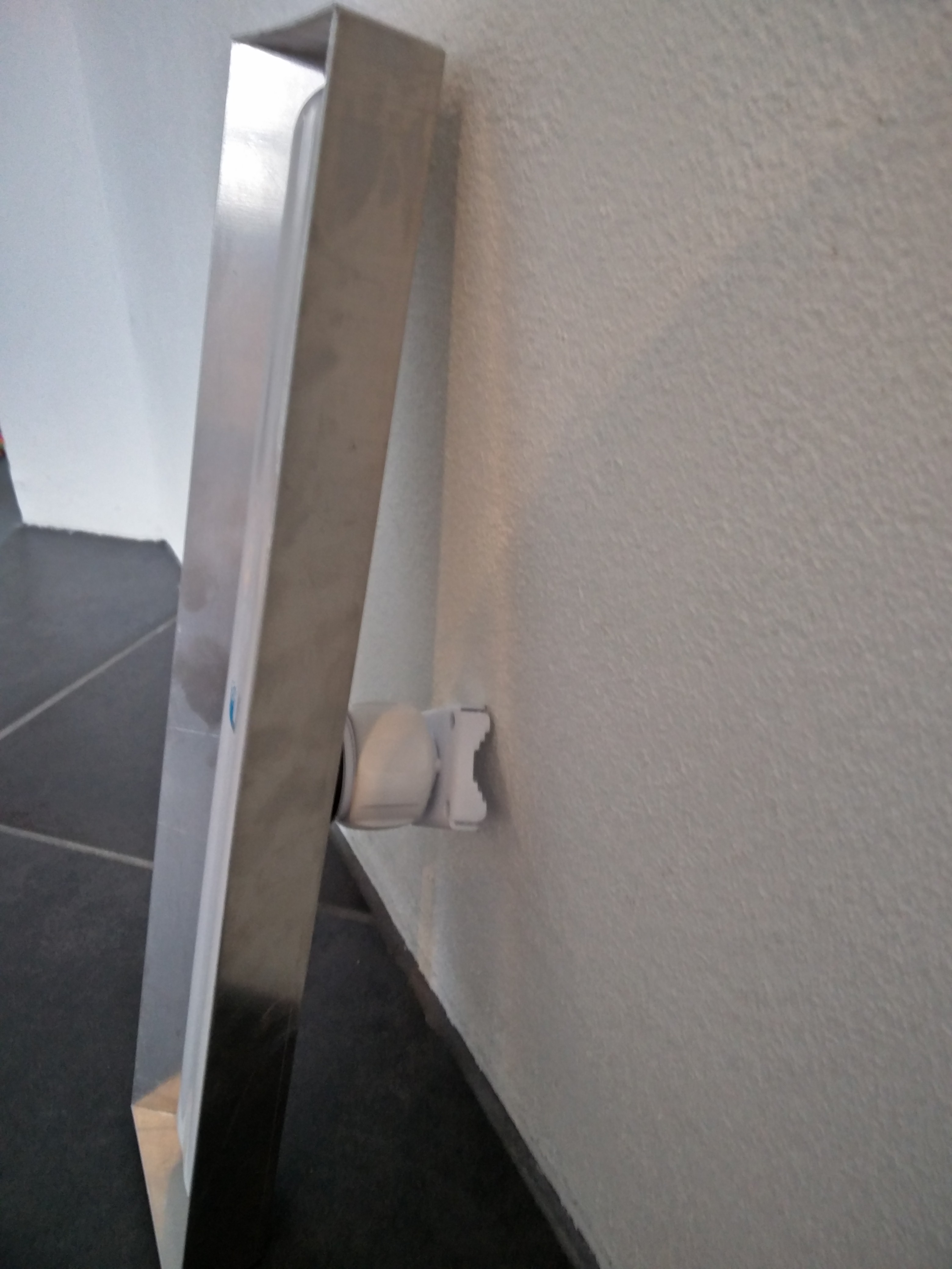

I have my prototype shield ready for the LiteBeam AC-120 AP (LBE‑5AC‑16‑120). Haven't tried it yet, just got it from my blacksmith....
If only I could find a nut with same screw thread I could tighten the shield to the AP....
@sirhc The blacksmith told me it was easy to make the shield. So please, start a production (it's to expensive to have small batches made). Also I'm sure you could make a nut to use....

I don't think the mount will hold up. Even fully tightened, I can still move the LBE with my hands. They have a low wind profile so it's fine, but a shield like this will catch MUCH more wind. Maybe add a small hitch to the back of the shield and a support rod to a pipe clamp.
I hate to be too enthusiastic, but the LBE sector is really great. $/performance, it's ubnt's best sector... I'd *LOVE* to see 2 shield kits. A 120degree basic kit like pictured (with a little help to the mount) and a 90degree kit to pull in the edges.
One nice thing is that the radio is actually down towards the bottom instead of behind the mount, so it shouldn't be too leaky.
