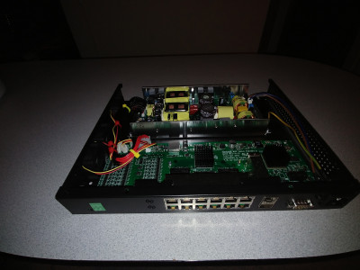

I added a couple of pictures..one of the AC model & one of the DC model, both rated at 600 watts...have have a user relay and external temp/humidty & door contact sensors...

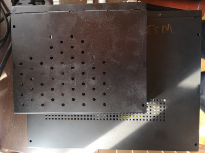

What I like less, it's HUGE and next version is suppose to be even deeper (40 mm deeper). It's ok for datacentrer but I doubt it won't fit several box we currently use at tower site. Attached the're apicture of the WS-12-250-AC vs the WS3-14-600-AC size. Maybe an upcoming version with smaller PS and form factor could be a good option ? Or a 2U version instead to fit the PS under the board ?

Mike99
The unit you have I believe is the deeper one already.
