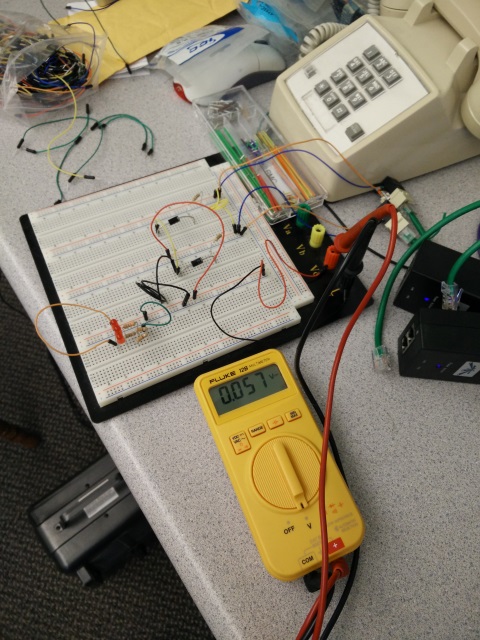

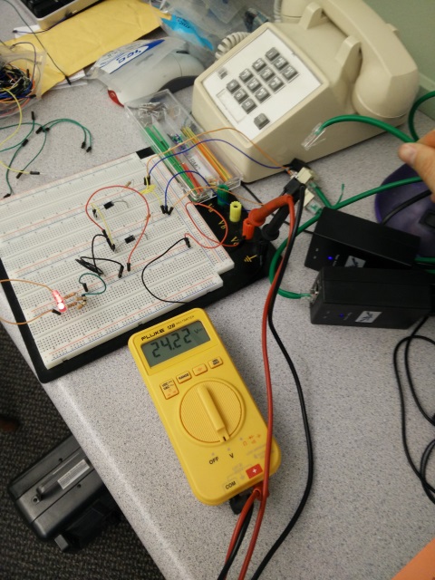

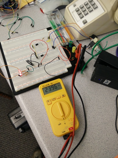

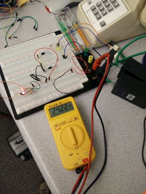

just for fun, I set this up on my bench.
2 ubiquiti injectors, a very simple schottky diode and a resistor per negative lead. positive leads are connected together.
The LED's and resistors are just a load. I had to stack some resistors up for power handling which is why you see 4 and I used 3 LEDs just to draw more power.
you can see that I can run with either supply, or both. When both are hooked up and I pull one, the LEDs dont blink or anything.
The resistors in front of the diodes are there to cause a voltage drop when the current draw increases, and that causes the supplies to balance out. These two supplies are .25v different so the higher output supply is used until the load reaches 250ma, then the 1 ohm resistor drops the voltage down -.25v and then both supplies run from their. There is some wasted power here, but it's pretty minimal.
