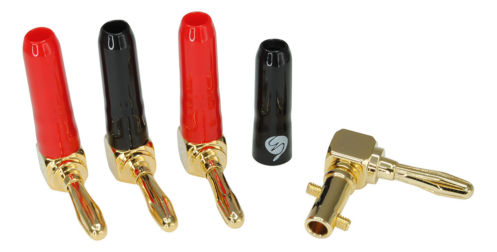

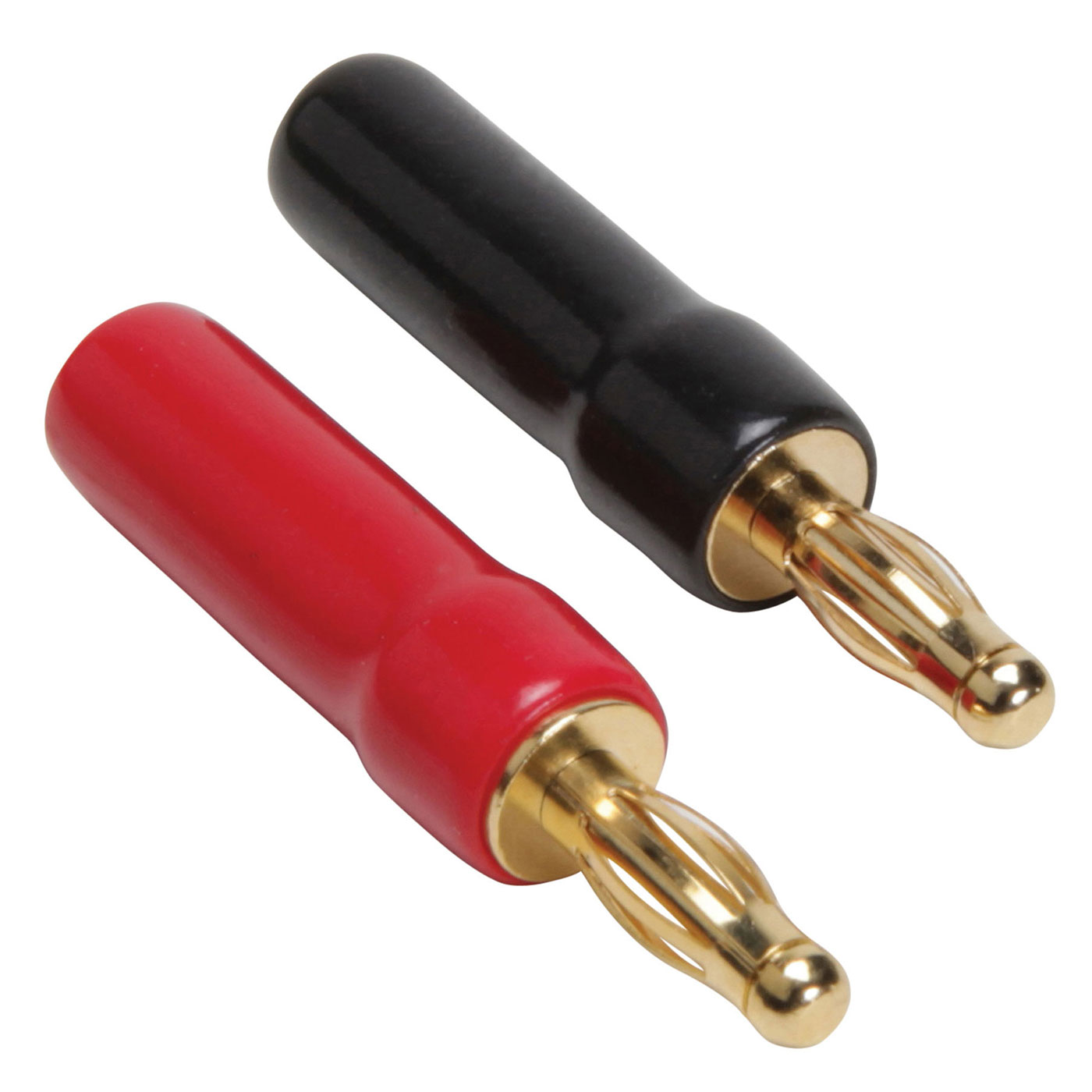

Have you looked into using Banana Connectors which plug into our DC terminals?

Be careful about over torquing those terminals as they are in a plastic housing.
I do not know, the banana connectors will only come out if someone pulls them out.
If someone want to be a jerk and pull your DC banna connector out what prevents them from simply unplugging Ethernet or FIber connectors?
They also make a 90 degree banana connector.
