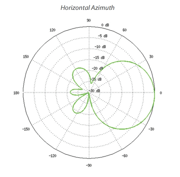

Actually, I just started looking closely at the LBE-5AC-16-120 return loss in the LiteBeam Datasheet ... wow ... am I reading it correctly? Seems like the chains are a mess? In the UNII-3 band, it seems to act like single polarity?
The low cost AM-5G16-120 is not great on the return loss uniformity, but seems more useable than this? Comments anyone?

I saw that as well. I think their charts are more pessimistic than reality though. People testing the LBE-AC units are reporting that they do MUCH better than the charts would have you believe.
Look at the radiation patterns.....DEFINITELY need to see an RF Armor for the LBE sector.

rebelwireless wrote:Look at the radiation patterns.....DEFINITELY need to see an RF Armor for the LBE sector.
Did you see the dB down points on the plots? OMG! The horizontal is almost 15 dB down on the 60 degree edges.

lligetfa wrote:Did you see the dB down points on the plots? OMG! The horizontal is almost 15 dB down on the 60 degree edges.
*wow*, how can they call this a 120 degree sector? -5 at the edge of advertised is too much. This is a 60-90 degree sector with sloppy edges :/ disappointed

rebelwireless wrote:lligetfa wrote:Did you see the dB down points on the plots? OMG! The horizontal is almost 15 dB down on the 60 degree edges.
Pretty much all of UBNT sectors are -6 dB on the edges.
However if you use the Legacy sectors with RF Armor we improve the edge drop off to less than -3 dB.
THere was no way to improve the Titanium sectors edge drop with shields.
