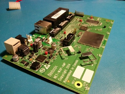

We have 2 indoor SOHO AP's coming out in about a month.
Atheros 2x2 MIMO 2.4 GHz only
HP - High Power
Integrated power supply built into chassis, no more Ethernet and power cables for homeowner to screw up.
Software enabled POE WAN port to drive radio on roof.
WAN port has blue line around it and included with each AP is a Blue Ethernet connector boot to make it simple for homeowner to know where to plug the wire from the radio on the roof.
4 port 10/100 switch
Based on Open WRT
Optional FXS port for those WISP that want to provide VOIP
HP MIMO 2x2 AP with POE WAN port MSRP $69.95
HP MIMO 2x2 AP with POE WAN port and FXS port MSRP $79.95

Posted: Mon Aug 11, 2014 7:45 pm
WAP
