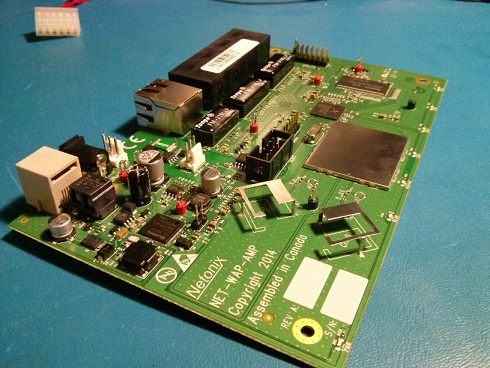

We have 2 indoor SOHO AP's coming out in about a month.
Atheros 2x2 MIMO 2.4 GHz only
HP - High Power
Integrated power supply built into chassis, no more Ethernet and power cables for homeowner to screw up.
Software enabled POE WAN port to drive radio on roof.
WAN port has blue line around it and included with each AP is a Blue Ethernet connector boot to make it simple for homeowner to know where to plug the wire from the radio on the roof.
4 port 10/100 switch
Based on Open WRT
Optional FXS port for those WISP that want to provide VOIP
HP MIMO 2x2 AP with POE WAN port MSRP $69.95
HP MIMO 2x2 AP with POE WAN port and FXS port MSRP $79.95

1) What will be the WAN POE output power voltage?
2) Is it GigE POE compatible? (For this price it would be as real bargain.)
3) POE power for the roof radio is an excellent feature! (I'm calling this a POE "server" feature)
But there are times we need the exact opposite because we want to place the SOHO AP in an area to provide the best coverage for a large house, but there is no nearby AC power, so POE ("client") power is very useful too.
What would happen in your design if the AC power cord is left unplugged, and instead the WAN port is fed, let's say 24VDC POE, from a separate power pack? Would if successfully run the SOHO AP, or do blocking diodes prevent that?
Re: Indoor SOHO AP ?
Wed Aug 06, 2014 12:38 pm
The POE WAN port is only 24Vdc.
We may consider offering a 48Vdc version down the road.
The device has the power supply built in so it can not be powered via POE, it must be plugged into an AC outlet.
The idea was eliminate the cable mess and offer an optional FXS port.
No, all ports are 10/100 Mbps.
Do not know too many WISP's offering 100 Mbps services so we did not feel it necessary at this time, maybe later versions in a couple years it will be needed.
WISP that offer VOIP currently have a real cable mess that the end user can really mess up and require a truck roll, this is meant to make the customer install simple with no cable mess.
One box does it all.
