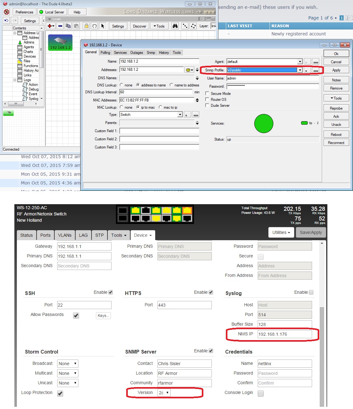

I am NOT a DUDE expert but I set it up and played a little but with it and it appears to work fine?
You need to make sure The Dude is using the same version of SNMP and ONLY THAT VERSION.
I asked my CTO at http://www.netlinx.net (My WISP) to set up The Dude and make sure he can also pole our switches.
I will ask Tom report back here once he has completed that task and is able to use it proficiently.
Entering an NMS IP address under the Syslog area of the Device/Configuration Tab will prevent all those Drop bear connections in the Log every time the NMS server talks to the switch.

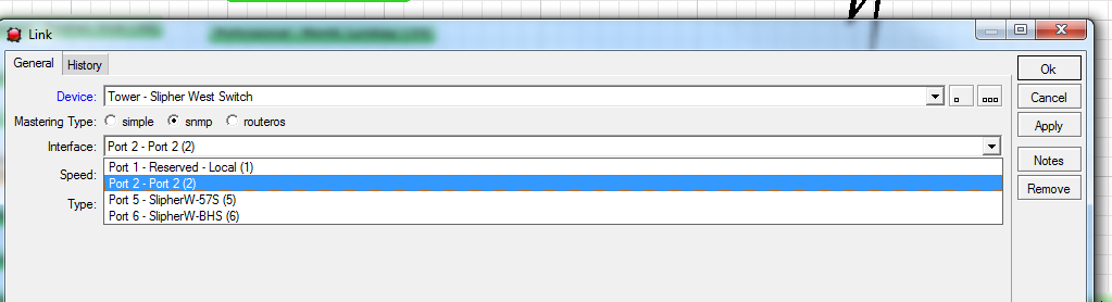

I can poll the switch and read SNMP in the Dude. However, when I add a Link between the switch and AP to show an interface usaged on the Dude Map it pulls the data correctly but the interface keeps disappearing and reappearing for long periods of time. Not sure if I described it correctly or not. This happens on V1 or V2c SNMP. I also get the "could not handle packet.....Bad Address error"
As you can see below it is missing ports 3 and 4 (6 port switch)
