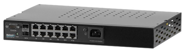

Today we released the WS-12-400-AC
This is the same as the WS-12-250-AC except that it has 400 WATTS of power and 2 cooling fans.
THis power supply is idea for HIGH POWER consumption sites where you are powering (4) airFIBER 5/24 and also maybe some AF5X radios and some airMAX radios.
Remember the WS-12-250-AC only has 250 WATTS and you are better off not pushing a power supply more than 80% capacity all the time especially in warm environments and if you are powering (4) airFIBER units then you are already at 215 watts including the switch power.
This would also be good for sites where you want to power up to (4) WS-6-MINI switches so they each can power an airFIBER and other radios.
It can be wall mounted with our normal chassis through holes and rack mounted with optional rack mount ears.
Click HERE to view the WS-12-400-AC.
