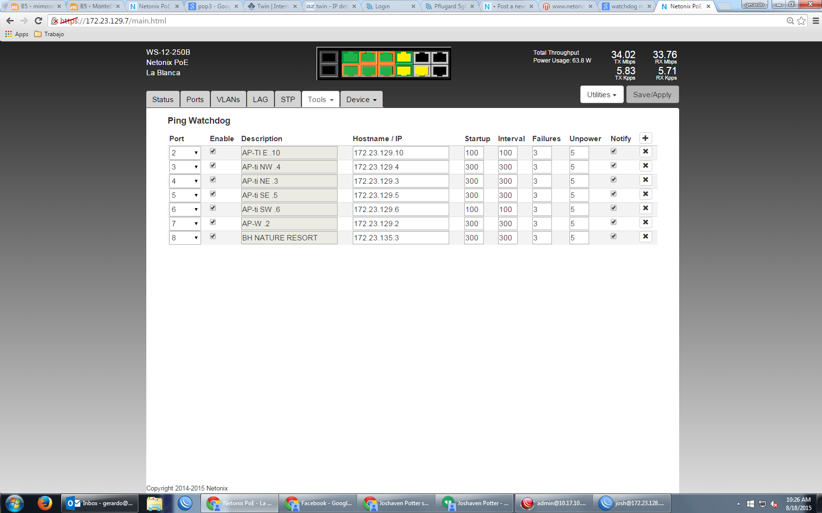

- by the way this are my settings please correct me, if I am wrong
- Screenshot 2015-08-18 10.26.56.png (174.07 KiB) Viewed 28453 times

I set up a watchdog on my netonix will this do port bounce to restore one of my devices if that device goes offline?
Yea, if you are running the latest version of firmware as there have been fixes to ping watchdog.
It is really pretty simple:
You select the port
You enable it or disable the Ping watchdog rule by checking the enable box
You give it a description
You give it an IP to ping
Startup interval (in seconds) - how many seconds it waits to start
Interval (in seconds) - between pings
Failures (count) - consecutive fails in a row to trigger
Unpower (in seconds)
Notify - if you have the smtp properly set up on the Device/Configuration Tab it will email you an alert when triggered

Re: Netonix Watchdog
There is a bug in v1.3.0 that when it powers of a port if only does so for a short duration.
It can affect the outcome that the unit may or may not power cycle properly since power is not cut for 5 seconds.
This bug also affects port bounces and scheduled port bounces as it only turns the power off for 1 second or less.
HOWEVER with that said I did just run a test Watchdog here in the warehouse where I had it reboot an airVISION camera and it did reboot it as expected.
DO NOT rapid fire port bounce devices as the continued IN-RUSH could damage equipment.
sirhc wrote:There is a bug in v1.3.0 that when it powers of a port if only does so for a short duration.
Chris What are your suggestions based on the settings that you see in my computer?? Do I need to wait for the update? or do I need to change my settings?
