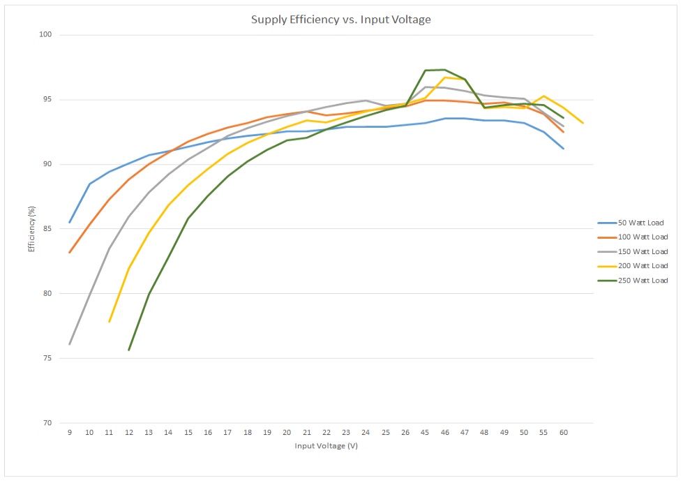

I guess I'm not certain how to confirm this. The WS-12-250-DC switch can take 9-60 VDC power with a 250 watt power supply but can output 48V powered radios - so to accurately predict the Amps under full load I'm guessing that I need to use the VDC IN value for calculation regardless of what the switch does with it.
24V input at 250w = 10.417 Amps max
The reason it's important is because I want to utilize the TPDIN-Monitor-Web (http://tyconpower.com/products/files/TP ... _sheet.pdf) unit to ping/power cycle the switch if needed and the relays support 10A 30VDC which is kind of on the borderline of my math. I can of course always lower the usage on the switch to ensure it's under the value but I want to check with someone who understands this a little better to confirm.

Hi, I am currently out of town & do not have my data with me, but your equation needs to take into account the efficiency of the dc-dc converter, so the fuse rating required for a certain load will also depend on the input voltage (and load of course).
So, using your 24 volts input at 250 watt load, according to the graph efficiency is about 92%. so equation should be:
Amps in = (Power/Vin)/effiececny
Amps in = (250 watts / 24 volts) / 92/100
Amps in = 10.42/.92
Amps in =11.33
But in reality, I doubt anyone will be using anywhere near that heavy a load, but same equation format will apply.
