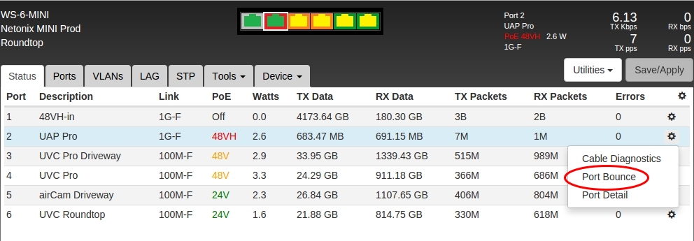

Yes Les is correct, try clicking on the little gear to the far right of each port row on the Status page.
I also believe in v1.3.X that gear exists on the Ports Tab as well.
It's called Port Bounce which powers off the POE for several seconds then re-applies the POE power.

Thanks....I found the "Port Bounce" function in the gear icon on both the Status page and the Ports page.
The function seems to work perfectly when selected on the Ports page but not when selected on the Status page. Selected on the Status page, the poe does turn off but never turns back on. You have to go back to the Ports page and reset the poe voltage and save.

This is being cause by the PoE Smart feature that disables ports that are unplugged. That part of PoE Smart is being removed so this won't happen anymore.
