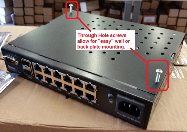

There are already threaded holes for rack ears that can be used with DIN rail adapters and there are adapters that you could use the through holes on.

If you notice there are 2 CHASSIS THROUGH HOLES that go from TOP to BOTTOM of the Chassis so you can run a screw through the Chassis to Mount to a wall or back plate?
We will eventually sell rack mount ears just not yet.
Possible mounting options for the WS-12-250-XX are:
1) "EASY" Wall Mount
2) Desk Top
3) Rack Mount with optional ears in the future

As mentioned, there are two through holes and there are holes for rack ears, either of which could be utilized with DIN adapters.
