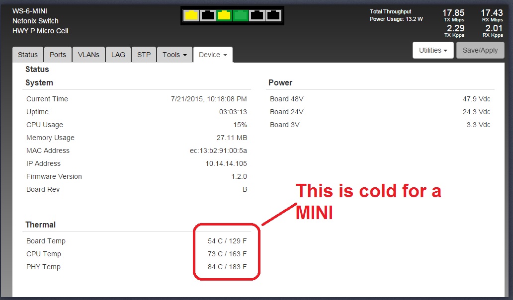

Is the MINI having issues? Is it too hot? What things can I look for?
http://pasteboard.co/28ETRnJG.png

Too HOT???? Not even close to a heat issue from your screen shot.

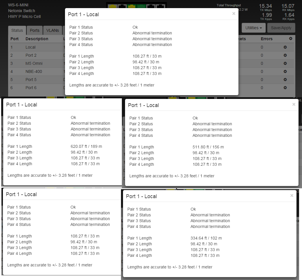

Can you do a cable diagnostics on port 1 and post the screen shot here and also tell me what is plugged into port 1 beyond the POE adapter?
My guess is a power issue possibly from a bad crimp.

Ran the test a few different times, mixed results.

- mini-cable-diag.png (90.76 KiB) Viewed 27915 times
Re: WS-MINI rebooting
Do you have an Ethernet Surge protector on this cable, they can mess up this test?

Nope, just right into an AF PoE. All the local customer has is a TP Link router plugged into the LAN side of the PoE brick.

Not sure what to tell you then?
If you have spare switch you could swap it out and if it still reboots you know it is NOT the switch then there must be something wrong with POE brick, cabling, or the homeowners power is blinking????

I'll try new ends tomorrow. After that I'll try a spare MINI I have layin around. Thanks
