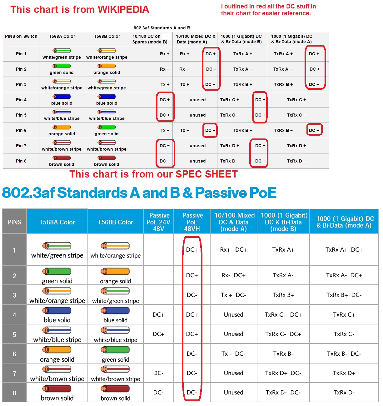

There absolutely is a standard for POE using all 4 pairs and it is 802.3af/at, here is the link to WIKIPEDIA
https://en.wikipedia.org/wiki/Power_over_Ethernet
PASSIVE POE was just a bastardized version since early PASSIVE POE DEVICES were mostly 10/100 they just adopted the unused pairs (Blue + and Brown - ) PIN 4,5,7,8.
As you can see we use the 802.3af/at STANDARD
So to answer your question the WS-6-MINI expects power on the 802.3af/at STANDARD as shown below
PINS 1,2,4,5 37-53V DC POSITIVE (+)
PINS 3,6,7,8 37-53V DC NEGATIVE (-)
NOTE: whatever voltage you supply the MINI is what it will pass out as 48V, MINIMUM VOLTAGE IS 37 V DC.
So long as your input voltage is above 37V the switch will run and it will output 24V as it down steps it to 24V.
DC Standard.jpg (411.11 KiB) Viewed 36119 times
