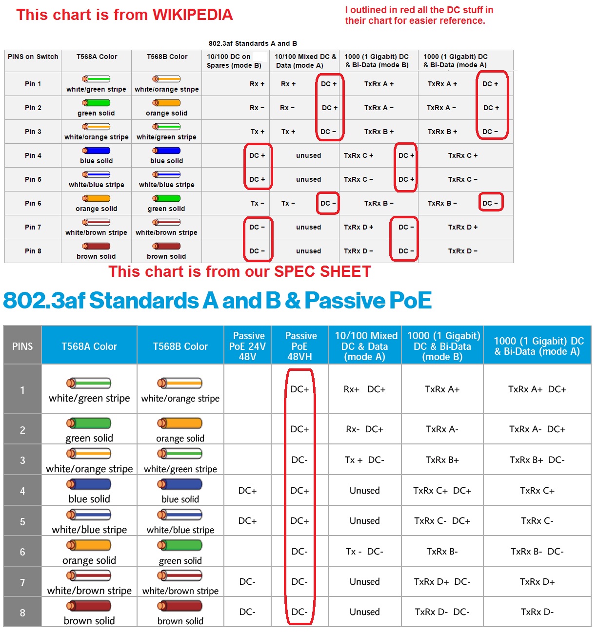

There absolutely is a standard for POE using all 4 pairs and it is 802.3af/at, here is the link to WIKIPEDIA
https://en.wikipedia.org/wiki/Power_over_Ethernet
PASSIVE POE was just a bastardized version since early PASSIVE POE DEVICES were mostly 10/100 they just adopted the unused pairs (Blue + and Brown - ) PIN 4,5,7,8.
As you can see we use the 802.3af/at STANDARD
So to answer your question the WS-6-MINI expects power on the 802.3af/at STANDARD as shown below
PINS 1,2,4,5 37-53V DC POSITIVE (+)
PINS 3,6,7,8 37-53V DC NEGATIVE (-)
NOTE: whatever voltage you supply the MINI is what it will pass out as 48V, MINIMUM VOLTAGE IS 37 V DC.
So long as your input voltage is above 37V the switch will run and it will output 24V as it down steps it to 24V.

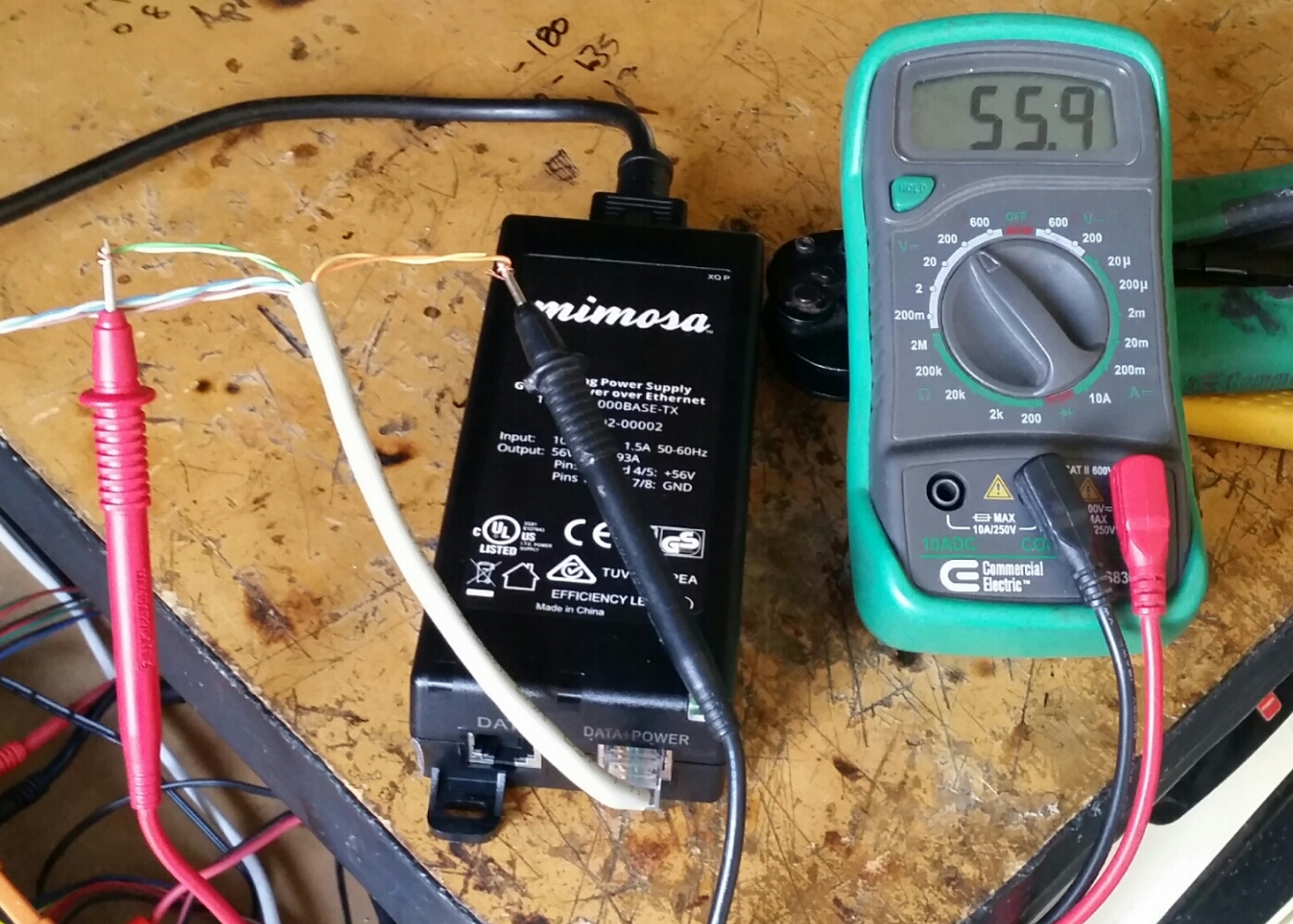

Re: Poe confusion ?
mimosa poe photo.......
- Attachments
- 2015-07-14 20.10.04.jpg (969.54 KiB) Viewed 36035 times
