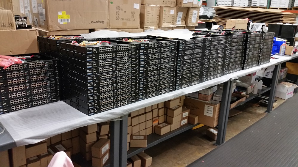

This is what I get to do tomorrow, this is a normal day's work for me on top of taking all your phone calls, over seeing assembly, ordering parts, designing new line of RF Armor stuff, the list goes on. Not enough hours in the day which is why I am just leaving now.
These switches are built and ready for testing.
Then I have 1 more batch of WS-24-400X for Friday.
Then Monday I start testing 1,000 WS-6-MINI, and after that 1,000 WS-12-250-AC.
We assign the MAC address and test each Ethernet port :working:
What you can not see in this picture is the other several hundred WS-24-400X units I already tested on the other bench to be boxed tomorrow.

Nice. You are doing a great job, Chris! It's fun and exhausting!
I see a problem though! No DC switches!!!!??? How are you doing on them? What is the latest ETA?
