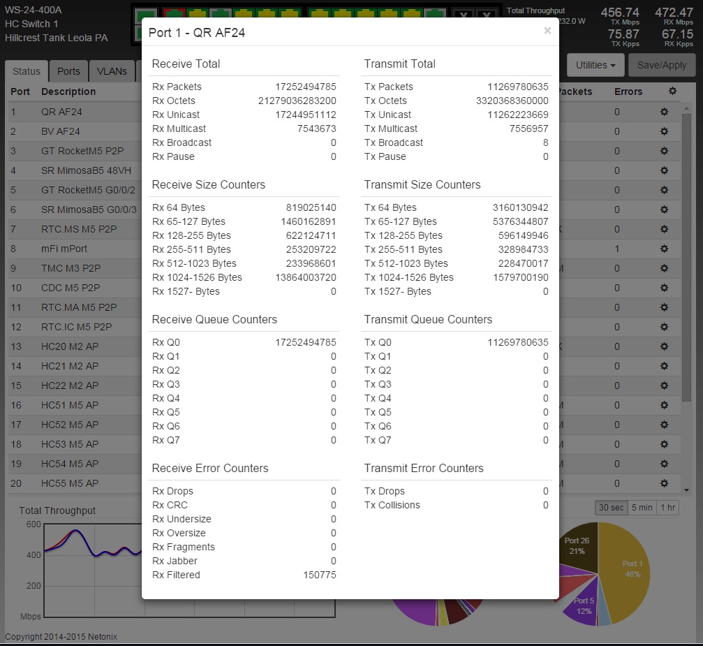

I just have a quick question. So far on the two WISP switches I have deployed I always see a large value on all active Interfaces under Receive Error counters ->RX Filtered. What does that mean and should I be concerned? Also to a lesser extent I see an occasional RX Jabber. What is that?
I can give more info about my setup if necessary.

Here is a screen grab of my second busiest tower and the main interface feeding it.
I too have those Rx Filters which I am not really concerned about but I do not have any Jabbers anywhere on any of my switches so I might try and find out where the problem piece of equipment is. I would be concerned about the Jabbers Errors.
