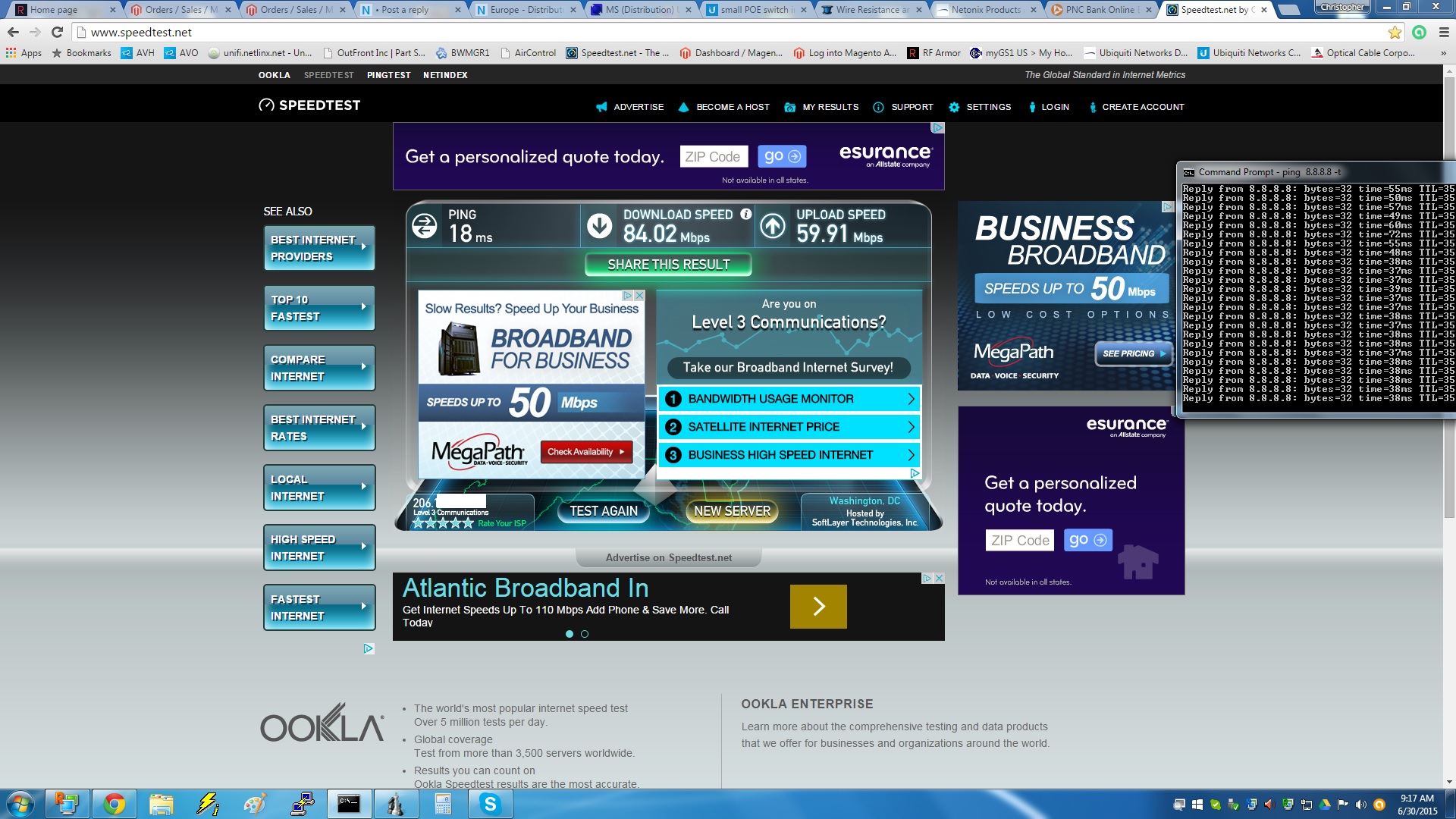

I do not ever have any issues Matt but then again I run Flow Control from the AP to the "Tower" Routers plus I have a Static LAG from the Switch to the Router to spread out the Flow Control Pause Frames from the AP's on each tower across 2 interfaces and I am pushing Pause Frames to a Routed Way Point at each tower.
This is the path to the internet from my house:
Level 3 Fiber Internet=>Router=>BWMGR=>Router=>AF24 Link=>WS Switch & Router=> AF24 Link=>WS Switch & Router=> AF24 Link=>WS Switch & Router=> AF24 Link=>WS Switch & Router=> AF24 Link=>WS Switch & Router=> AF24 Link=>WS Switch & Router=> Legacy M5 AP 30 MHz channel DFS=>NanoBridge M5=>My House
I share the AP with about 10-15 other customers. AP is about 2 miles from my house.
CLICK IMGAE BELOW TO VIEW FULL SIZE
