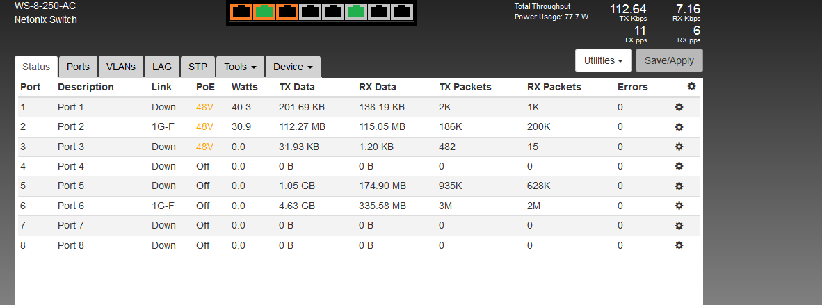

I picked up two WS-8-250-ACs to try out. So far I have been using them as pretty much just a power supply while setting up equipment for installation. The POE options are really nice. I seem to have run into a problem though. I was powering a Siklu on port 1 (48V) and it lost power all of the sudden. Moved it to port 2, also set to 48V and it came back up no problem. Now port 1, with nothing plugged in shows 40Watts. Any ideas what went wrong?

Yes, I should have mentioned. Everything seems fine except POE , 24V POE does not work either.
