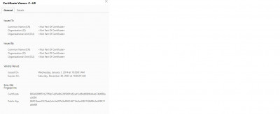

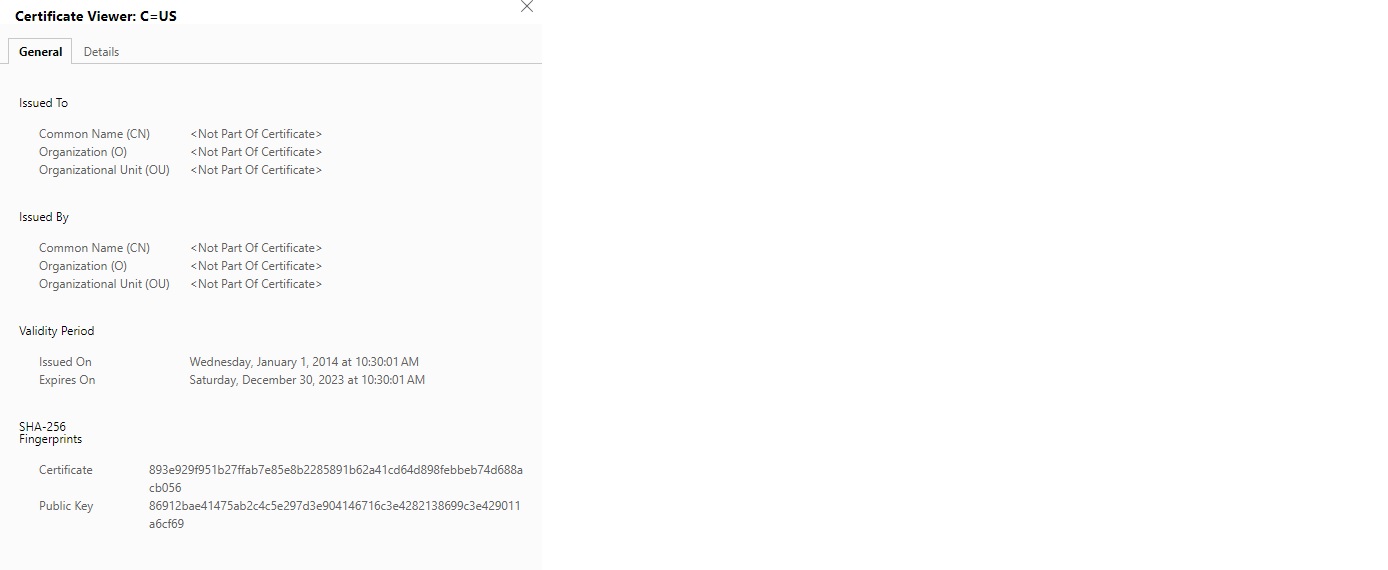

Thanks for your response. So, I assume the cert will be renewed automatically post the mentioned expiry date. Else, I would need to reboot the switch or clear the browser cache. Is that correct? I have herewith attached the screenshot of the certificate details as seen from the browser.
Kindly confirm if my understanding is correct. I was wondering if there would be a way to delete the existing certificate and generate a new default certificate on the switch. Is that feasible?
