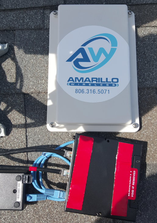

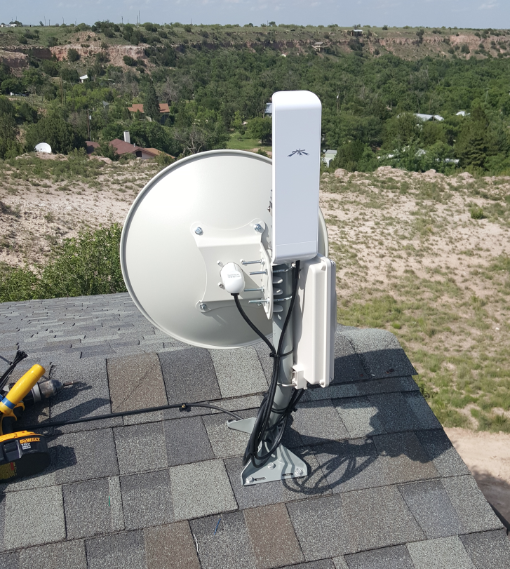

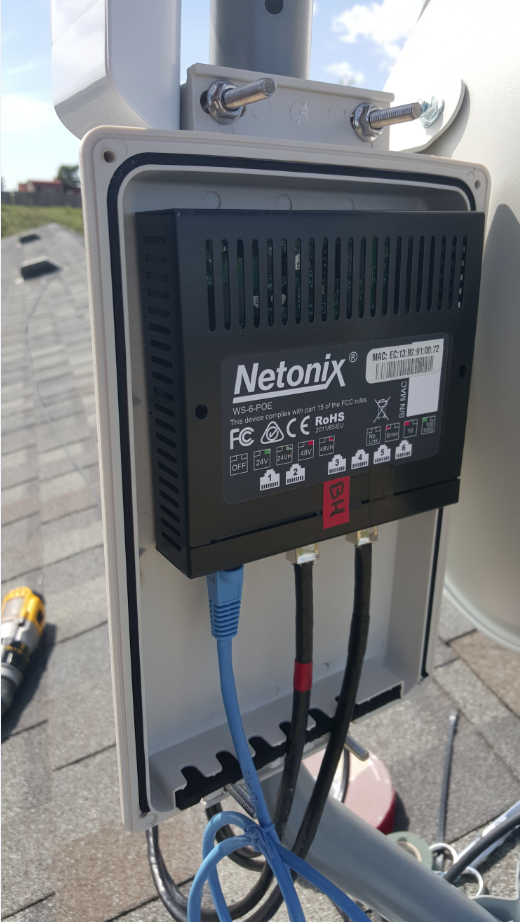

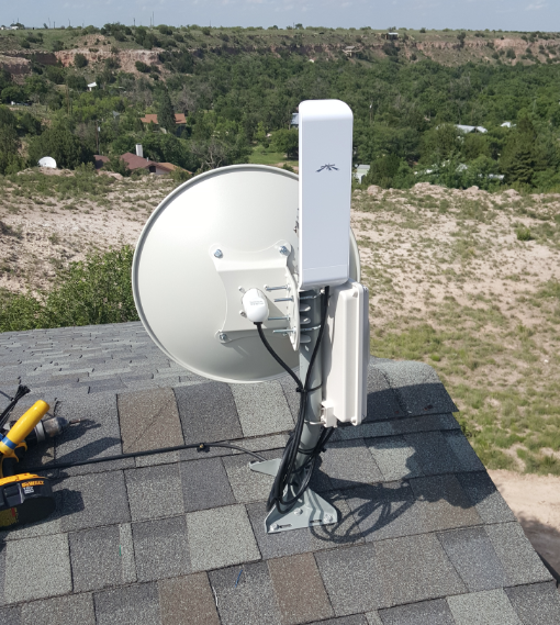

Been meaning to post this for awhile. Here is our first mini pop done up with a WS6 and the tycon enclosure. I REALLY like this.
way to go guys!
We used double sided sticky tape to hold the switch in the box

I would really like to see you guys screwing/bolting these MINI units to the Tycon Power box instead of Velcro.
If you take a WS-6-MINI apart you will see that it has a BIG thermal pad that connects the PCB to the metal chassis making the chassis the heat sink.
The metal chassis should be flat against the plastic wall to help transfer heat to the outside.
If you pre-drill holes though the plastic chassis then use long stainless steel pan head screws you can put a dab of silicon under the screw head on the outside then use two small washers and hex nuts on the inside to hold the switch in place tight against the box inside wall. (Make the box up ahead of time at your shop to allow silicon to dry)
Velcro is not so good as it will not allow heat to transfer outside the box and when it gets hot it will peel away and the switch will fall inside the box and possibly cause cables to come un-plugged.

Thanks for the tips. Don't really like drilling holes in boxes like that. But I understand you concern. We used double sided outdoor rated sticky tape (it's bad ass) so I don't think it will come lose... if it does I guess we learned our lesson. :)
Yes, we use your shield kits on almost everything.
In this case it's a NBM5 connected to a DFS sector. (no nanobeam/powerbeam) and the nanostation is on 2.4Ghz so I wasn't really to worried about interference.

If you drill it slightly undersize, when you drive the screw in with a drill/driver, the heat from friction should soften the plastic just enough to form a seal.
Anything I have ever stuck up with double-sided tape eventually let go so I must be using the wrong stuff. Mostly just use it to hold in awkward places until I can get a screw in. I've never heard of outdoor rated stick tape. Got a brand?
I suppose it should transfer heat better than peel'n'stick Velcro.

Great setup Adair! We'll have a similar setup we're going to use omni's on (yes, I need 360ยบ short range coverage) where the area will have a dozen or so micro-pops because of heavy foliage.
