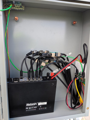

If I have room, I use the rack mount version with one of these
https://www.mccowntech.com/product/4-sl ... rotectors/https://www.apc.com/us/en/product/PRM24 ... kmount-1u/For the inline, it ends up like this
- Netonix with 800-POE-FUSE
