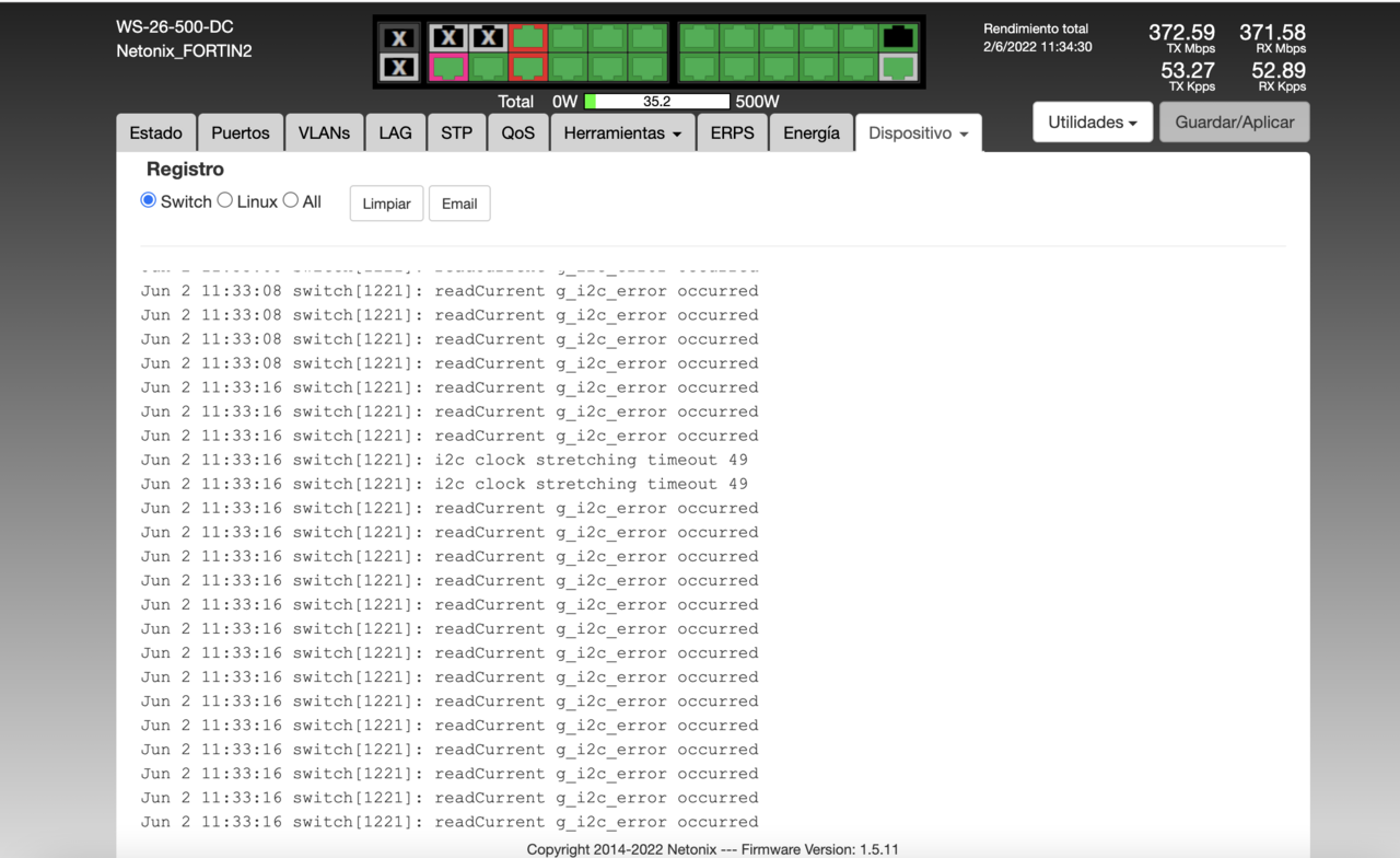

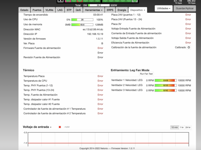

some solution to the error this morning the batteries were discharged and the switch sends this message
readCurrent g_i2c_error occurred

Re: readCurrent error
Sun Jun 05, 2022 10:41 am
Seems like broken sensor.
thomas
Posts: 42
Joined: Fri Jan 14, 2022 1:46 pm
Been thanked: 4 times
Mon Jun 06, 2022 5:55 pm
definitely a hardware issue. if netonix won't fix it, I will.
