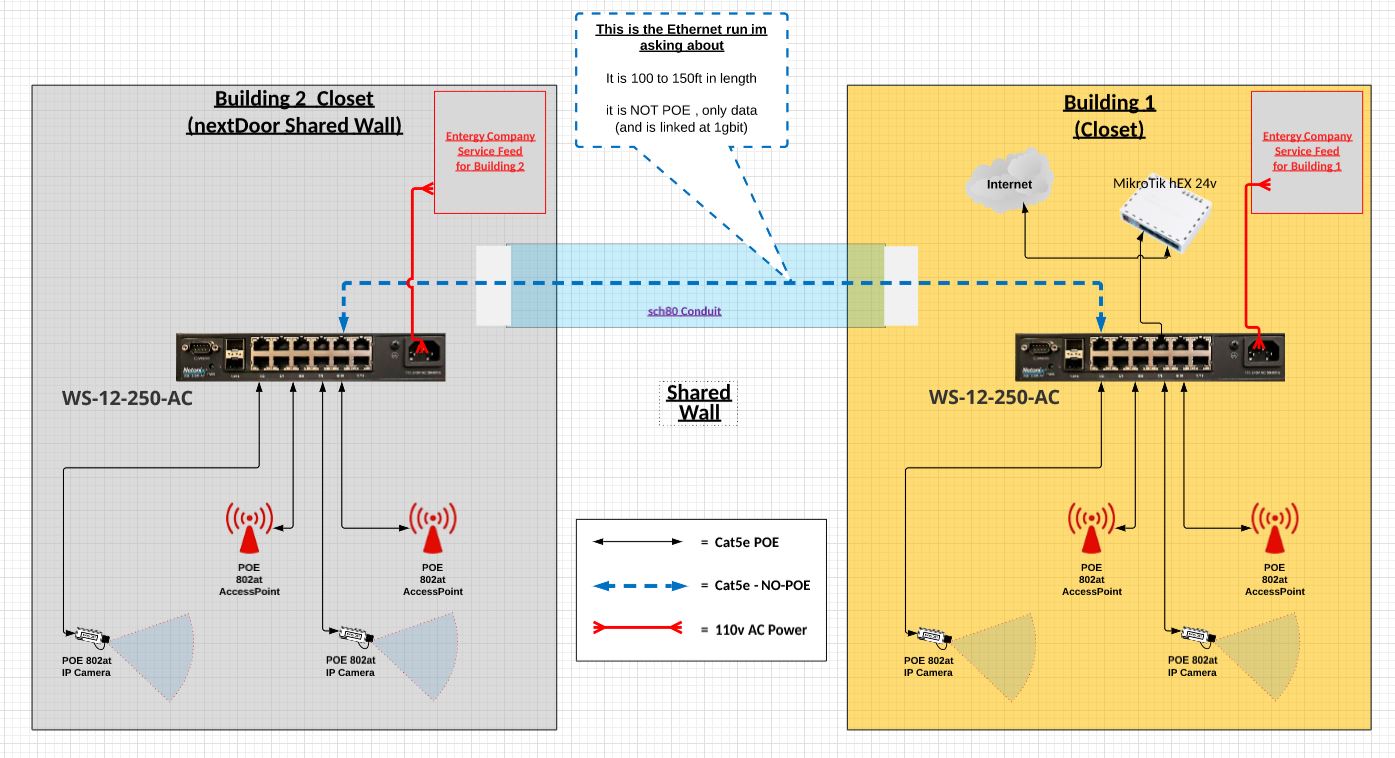

(see map below please) - I have 2x buildings that share a common wall, each has its own Power Service panel / Utility Feed. (one is a 12-unit apartment complex, the 2nd is a 4-unit apartment complex). I have sch80 conduit run about 120ft from Building 1's data closet TO Building 2's data closet - and in that conduit 3x runs ~140ft each of Shireen DC-1030 cat5e connecting the two closets (DC-1030 is Outdoor rated, non-shielded, No-Drain-wire, CMR solid-awg24 with gel-tape). Both closets are on the 1st Floor. There is no POE across this data run, 1gbit data only. Building #1 has a: Netonix WS-8-150-AC, building #2 has a: Netonix WS-12-250-AC
My question is: How can i best ground / isolate the power of each data closet, at this point? (i am trying to resolve ground issues in regards to this quote) NB: i am NOT seeing data errors, just blown ports at times:

(i clearly should have ran fiber in the conduit, but did not know any of this, and re-running fiber is not an option at this point). To be clear- Internet is provided via a cable modem -> Mikrotik router -> building #1's switch.
layout today

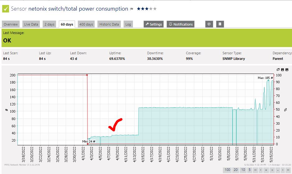

building #2 netonix webGUI current sensor starting to acting up due to ground issue (most likely)
Building #2 - total power draw, showing the current sensor WAS good for a few weeks, then started acting up due to grounding issue

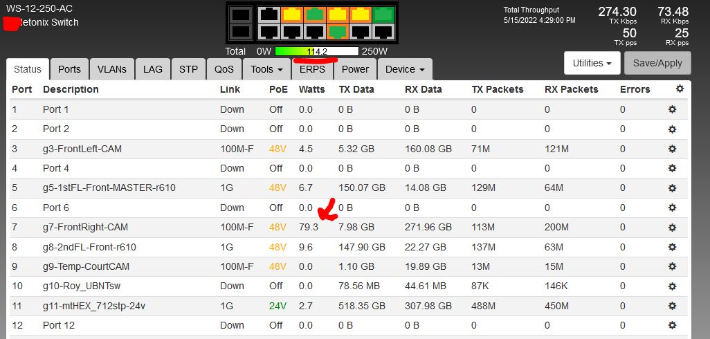

See my post with the Netonix "Cable Diagnostic" output of various (good and failed) POE devices :
viewtopic.php?f=14&t=7449
