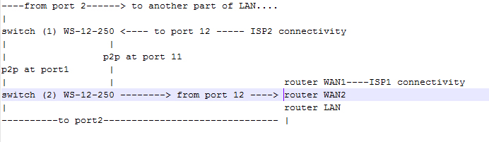

I am sorry for maybe a basic question, BUT I am little bit lost in VLAN configuration. My symplified situation is as folows:
So what I want to do is in fact divide two switches into four independent switches. So what I think need to do
* select ports 11-12 as VLAN2 UNTAGED on both switches?
* leave ports 1-10 as VLAN1 UNTAGED (and Management) on both switches?
* and then I have to select and configure trunk port(s)?
As you can see, there are two connections between switches but while the first connection (on port 11) is incomming connectivity to router (WAN2), other connection (on port 1) is the LAN behind the router. Both connections are two independent p2p wireless links. I need them both completely separate like independent switches. Is there a solution for this task via VLAN?
Thank you in advance!

Thanks for detailed reply. Mentioned settings is the first one I did try. Are you sure that with this settings on both switches I can connect both switches together via port 12 (12 to 12) and port 1 (1 to 1)? On my test it seems there was a loop but I can test it again. So for my case, no trunk configuration necessary? Do I have to change MTU on these ports or 1528 is enough?

Unfortunately if I have 2 switches exactly with this configuration above and then:
1/ if connect port 14 to 14 via patch RJ45 cable (in production it will be wireless p2p link) then
* device connected to port 11-13 can reach device connected to port 11-13 on other switch - OK
2/ if add another patch cable and connect ports 1 to 1 then
* devices connected to port 11-13 cannot reach (!) devices connected to port 11-13 on other switch - ???
* but devices connected to ports 2-10 can reach devices connected to port 2-10 on other switch - OK
So I am at the begining, that is why I create this thread..what I am missing? Thanks.

Not sure if you uderstand the root of my issue, so again, if both "parts" (defined by two VLANs) of two switches are connected together, then only one part (management VLAN) of the switches is working and other part (VLAN) does not work. To be working means that devices conencted to each part (VLAN) of switches can communicate together. Not working means, that device connected to port 11-14 on VLAN2 of switch1 cannot reach device connected to port 11-14 on VLAN2 of switch2. So I am not talking about reachability of switch web UI from VLAN2.

It seems that the root of my issue is the STP that is not supported to run in multiple instances , see here so it seems now that it would be enough to disable STP on both trunk ports (1-1 and 14-14) and on both switches! :-) (otherwise STP do not care about separate VLANS and still thinks there could be a loop and disable one path).
